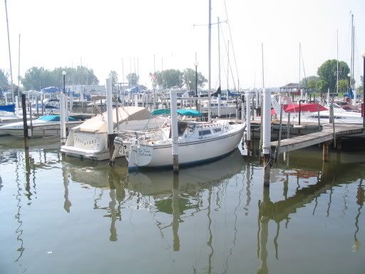

Hi All, below is a pic of La Tina Caliente in her new slip. I am taking the picture from the dock leading out to the boat. I have to back out of the slip and towards the dock to get out of the marina. You can see that I do not have much room at all for manuvering. So, I sent away for a product package from EZ Steer. In this case it is a must have.....but, unfortunatly I do not have the extra money to buy it ($200.00 at Cabelis). So I started looking around the shop for some bits that I might be able to fabrecate into a steering system. This spring I replaces the pintals on the rudder and looking at the old ones, I realized that I could mount one on the back of the rudder with the pin pointing up and strap the other one on the back of the outboard with the pin pointing up and make a rod to go between them. I will post pics when I get it hooked up. Cheers.

Hi CS, when my motor is down, the handle is in the up position and also with the stern pulpit I have, it is difficult to reach through to turn the motor. I am in such tight quarters, I would just feel more comfortable with a more ergonomic system. Cheers/

Hi CS, when my motor is down, I can hardly reach it. I can turn the boat with just the tiller with the motor locked and going forward, it turns fairly tight, but in reverse, in the tight quarters I am in, the tiller is not enough. Cheers.

I can't find the thread but recently someone referenced an excellent guide for docking and mooring. A technique he identified for your situation goes like this: Before backing out of your slip, throw a dock line over the post on the aft starboard side. Have one end cleated on the starboard side of the boat and just hold the loose end. Let the line out so you can back out most of the way and start your turn, by holding the line and steering, your stern will walk around to starboard and your bow will fall off to port, thus setting you up for a shift to forward and easy escape. Just drop your (floating) dock line and haul it in quickly without fouling your prop.
Less speed the better so as to not re-injure your shoulder Prop walk will be working against you here but it should still work OK.
I am assuming you want to head off to port, just reverse everything if not.
Hope that works for you.
