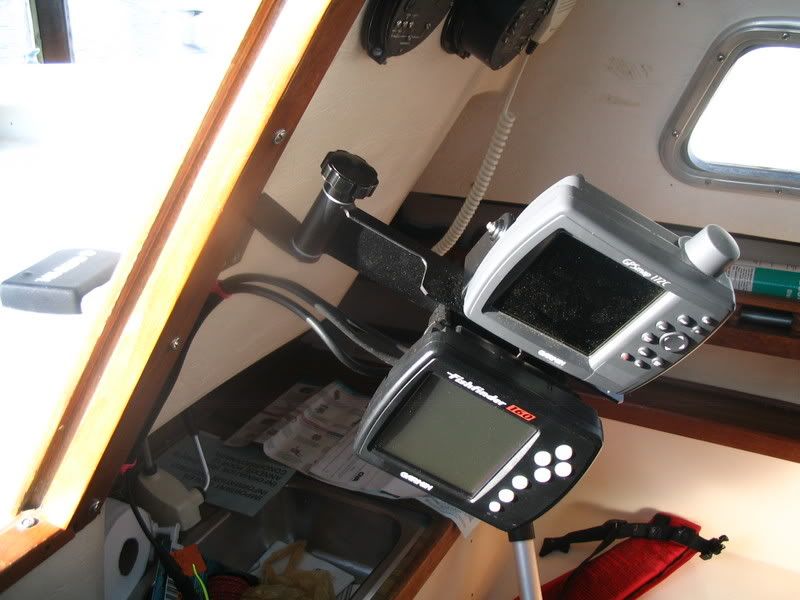

Response Posted - 11/09/2007 :  16:57:22  Show Profile
This is what I used on my C25.
Response Posted - 11/10/2007 :  17:12:54  Show Profile  Visit aeckhart's Homepage
With radically declining depths on Lake Superior these days a depth sounder is a must. I'm just not sure if I want to eliminate my remaining round instrument, cover the holes with something, and mount a new chart plotter (with depth capability) on the bulkhead.....or not. The alternative is Raymarine, B&G, etc all of which are square, require covering the holes anyway, and are almost as expensive as a new chartplotter.....at least for multifucntion instruments. I don't like to be cheap with these things since they are very useful safety devices in frequent Lake Superior fogs and for night coastal cruising. I don't want to break the bank either. Thus the dilema. Be sure that before the boat is in the water next spring I will have made a choice one way or the other.
Very nice setup Dennis. I'm not a fishfinder kind of guy though. I've got a 2" diameter hole in my bow waiting for a new transducer of some type.

Response Posted - 11/10/2007 :  23:27:47  Show Profile  Visit OLarryR's Homepage
I also installed a fishfinder using a RAM Swing Arm. chart plotter could be installed similarly. I like the fishfinder because it provides sort of an indicator as to the contour of the bottom. The transducer was mounted inside the hull using a toilet bowl wax ring to hold it in place. I made a Starboard circle and covered up the non-working original Depthfinder hole. If the photos do not show below, then go to my website.
