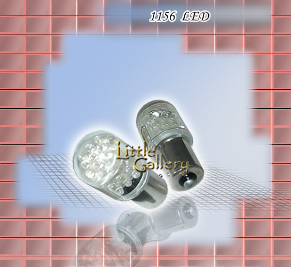

Hey guys I just found and bought this on ebay. This will fit my enclosure for my anchor light.
[url="http://cgi.ebay.ca/ws/eBayISAPI.dll?ViewItem&item=270222429305&ssPageName=MERCOSI_VI_ROSI_PR4_PCN_BIX&refitem=270221595003&itemcount=4&refwidgetloc=closed_view_item&refwidgettype=osi_widget&_trksid=p284.m185&_trkparms=algo%3DSI%26its%3DI%252BIA%26itu%3DIA%252BUCI%26otn%3D4%26ps%3D42"][/url]
1156 LED Bulbs
Comes in a pair(2 bulbs)
12 volts, 27 LED
Superwhite Color
Easy to install, no modification needed
$8.95 + shipping.

They look pretty small too. I don't have specific measurments but from the picture it looks like the top part is no longer than the bottom. Very compact. I was very disapointed that I couldn't find the other model everyone bought. But this one looks even better with side illumination. I'll use 1 in the mast and 1 in the cabin. They are initialy designed as side blinker lights. I hope they wont start blinking! If they start blinking then I'll turn up the disco music and call it a party.

I have followed the postings on the Cat250 LED light discussions. I guess my question regarding these bulb replacements and especially for applications where there are regulations (USCG) regarding visibility distance, etc for anchor/running lights, how does the above lightbulb specs stand up to 1NM/2NM visibility ?
My earlier investigation and use of LEDs is that the LEDs come in a wide assortment of configurations and it is extremely hard comparing them to each other and to the USCG reqmts unless they are actually approved by USCG and as far as I know, USCG does not approve lightbulbs alone, only those in their own housings.
I guess my concern is that there is a big difference in getting just a lightbulb as a replacement and install into an existing incandescent housing or a housing bought to fit the new bulb versus buying an LED with it's own housing. The cost is like getting a regular anchor light w/incandescent bulb and housing for say less than $100. an anchor light w/LED and housing for well over $100 or an LED lightbulb put into your own existing housing or purchased separately housing for less than $10 for the LED.
Also, these LEDs are not all created equal and very deceiving in brightness. I bought some replacement LED bulbs which I use in the cabin in the original Cat 25 housings, those bulbs have about 6-8 little LEDs (similar to your photo but in a festoon bulb arrangement) and their brightness is about 2/3 of my incandescent original bulb but do save quite a bit in amperage - probably about 25% of the amperage of the incandescent bulb. However, my OGM LED Anchor light which is USCG approved (approval ltr on their website) is rated for 2NM and this is all by one little LED in the bottom of the housing. However, this is a very bright single LED and there is a whole bunch of micro-circutiry under it which not sure all that it does but obviusly is more sophisticated than just a bulb replacement like what I used in the cabin. I forget the mfr but there is one LED Mfr that sells replacement bulbs for the inside cabin and their bulbs cost about $30 a piece (it's called a "smart something or other") and it also has micro-circuitry under the bulb. However, there bulb is extremely bright and not same comparison as just a bulb replacement.
The LED technology is great but the specs and rating of the bulbs leaves something to be desired. It really takes a lot of review to ensure you are getting an equal brightness/visible replacement for what existed on the boat originally. if you have any specs on that bulb you show in the above posting, I would appreciate the info.

I can't tell you anything about the specs on the bulbs I bought. The only way would be to do a side by side comparison on a USCG approved and the one I bought. If mine is brighter then I guess we're alright. The bulb in question boasts "superwhite" and has 27 LED. The one that the other guys are using has 28 LEDs. Of course the LED type is important. All I can say at this moment is that from the picture it looks promissing however they don't say "HID" (High Output Diode) or SuperBright. Worse case scenario I'll use them in the cabin.
