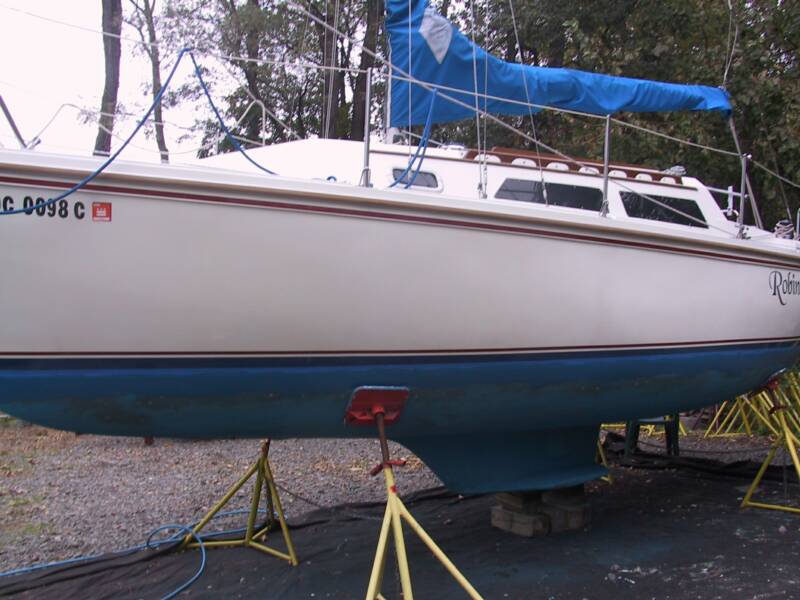

Nice topic for VC17.
I'd like to see a pic and same thread for Micron Extra with Biolux.

Looks sweet Randy,
now tie that boat down to the trailer and the trailer to the tiedowns.
JIC.

The PO had some brand of ablative paint on the bottom. It lasted 4 years with him. I, same as PO, keep my boat in the water all year-long. During the past seasons, I had that 4 year old paint pressure washed annually and after 1 full addl year (5 years total - used on the Potomac River - slime is the issue...not barnacles), it was time to repaint the bottom.
I had the bottom painted with Micron Extra. It acts like an ablative. It is a copolymer that also sort of is a soft paint and comes off with time. I have had it pressure washed after the first year with it and while the bottom had a slime coat, it was not all that bad...came off easy enough pressure washed. I have photos of when the boat was in the yard and being painted but unfortunately I am at work and cannot access those photos which are on my PC and not on my website. If I remember, I will try and load those photos tonight or perhaps tomorrow or so to give you an idea of how the Micron Extra looks new. But to tell you the truth, I think most paint jobs regardless of what is put on is going to look great. It really has to do with the prep work. Okay, maybe a hard finish paint is going to look a tad better. The real photo you would want is what does these paints look like after a year or so before and after it is pressure washed or whatever needs to be done to bring it back to just paint. Also, if the boat is kept in the water all year-round and if those waters are fresh or saltwater is going to have a big impact on what the paint jobs look like after a year. Obviously, a single season paint job is going to be redone year to year but if you want a multi-year paint job, then you are probably going to go with a soft paint....but it's flat looks hard unless you are real close up to it and don't run your finger along it...or you will have a blue or red, etc finger. I can tell you that after 4 and even 5 years using the Ablative paint (in freshwater w/heavy slime issues), the bottom of the boat looked very good after a pressure wash. That is really something compared to those days when I used a single season paint. The marina (Washington Sailing Marina) across the river from where I keep my boat regularly has a Tuesday pressure wash special for $75 - that's raising the boat out of the water, pressure-washing it and lowering it back in. At that cost, it is a good deal. Some do it twice a year. I have been doing once a year as the PO owner did as well. But this year, I may get it done this Spring besides when i normally have it done in the Fall. that is because during the winter, I hit something in the river - probably an underground log or something (while I was in about 4 1/2 foot water). That was some hit with the keel taking a big hit that slowed me up but rolled over it. I am curiious to see if there was any damage. No water on the inside from the keel bolts..so I am hoping it is still seamless between the keel to the hull bototm and that the keel/wing has no major dents.

I was checking my records and I did paint the bottom with Micron XT. I have photos, unfortunately they were taken before the complete job was completed and the photos do not really show off the bottom that well - Photo area bit dark. Anyway, I think I took the photo after the yard worked on a few of the paint blisters and about 4-5 dime size real blisters. They first put some waterproofinh paint on and then started painting. So...the photo reflects only a very partial paint job.
