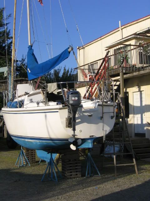

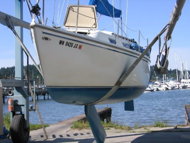

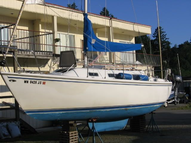

Hello Folks,
Here is an update regarding my boat on stand inquiry at the start of this message board.
I was extremely lucky to have joined the Oneida Lake Marina located in Central New York. I was fortunate to have met the owner - - his name is Ron - - of the marina who was incredible willing to work with me to get my boat on the hoist and leave it up for a week in order to get the painting completed. Ron offered to supply plastic, offered tips, checked the painting, and let me work at a pace to get the job done well.
I have placed a few picture herein for the purpose of sharing my experience. I have to admit, the hoist made it extremely easy to get to areas that needed to be scraped and painted.
Heading to the set up the mast.
It was a great experience to learn so much and meet an owner of a marina so passionate about people and boats. If you are in the area, look me up at the marina.
