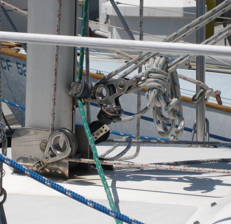

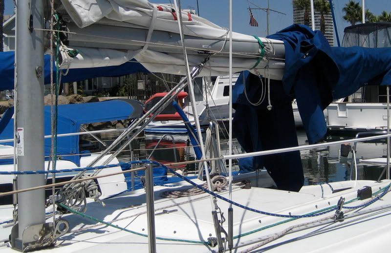

willy
422 Posts
Response Posted - 08/21/2008 :  20:44:40  Show Profile
Frank,
can you post a pic of your cunningham set-up?
Willy

AADIVER
966 Posts
Response Posted - 08/22/2008 :  16:40:27  Show Profile  Visit AADIVER's Homepage
The first pic is a wide shot. Notice I've re-attached the vang. Second shot is a close up; the Cunningham is the green line.
Edited by - AADIVER on 08/22/2008 16:42:32
Response Posted - 08/22/2008 :  17:17:35  Show Profile  Visit piseas's Homepage
Frank, nice job but looks like you could use some deck organizers and/or additional clutches. Maybe hit the swap meet this weekend!

AADIVER
966 Posts
Response Posted - 08/22/2008 :  17:37:33  Show Profile  Visit AADIVER's Homepage
"...what made you decide to re-install vang?"
In the rather unlikely event I have to sail downwind in a strong wind. The two blocks and lines don't interfere with each other.
"additional clutches" for what? I only have four lines leading aft: main halyard, luff reefing line, the Cunningham, and the dousing line through the cam cleat on the hatch lid. Did you know from '06 on Catalina eliminated one of the starboard clutches? Duh. But they won't simplify the convoluted, inefficient reefing system.
