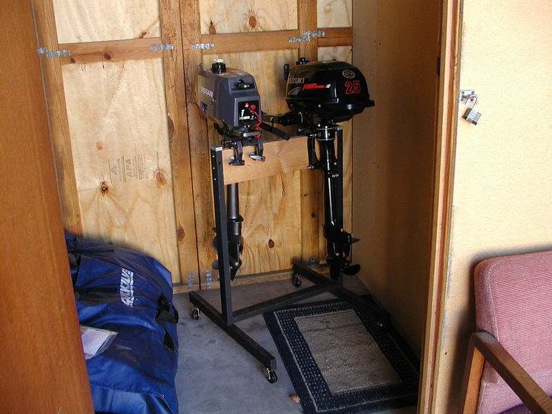

I made a motor rack out of 2x4's, 1x4"s, and 2x6's to hold 2 motors. It is 36" wide and 35" tall, excluding casters, and to accommodates our new 25" shaft 9.9 Nissan. Cross brace feet at the bottom are 24" long 2x4's. I put the casters on one end so I could wheel it around, when necessary, and 2x4 blocks on the other end to level it, almost. The cross bars at the top and bottom are 2x6's with vertical 2x4's between them, held together by vertical 1x4's top to bottom on each side. All done with nails and wood glue.

I already had a very heavy steel 2' x 2' dolly, and I added a canted engine stand made of 2x3's and 2x4's to fit exactly into the top of the dolly frame, similar to DavidP's idea. My Honda 9.9 weights a little over 100lb. I have stored my engine in the basement on this stand with the wheels, and moved it to/from the boat with this, too.
