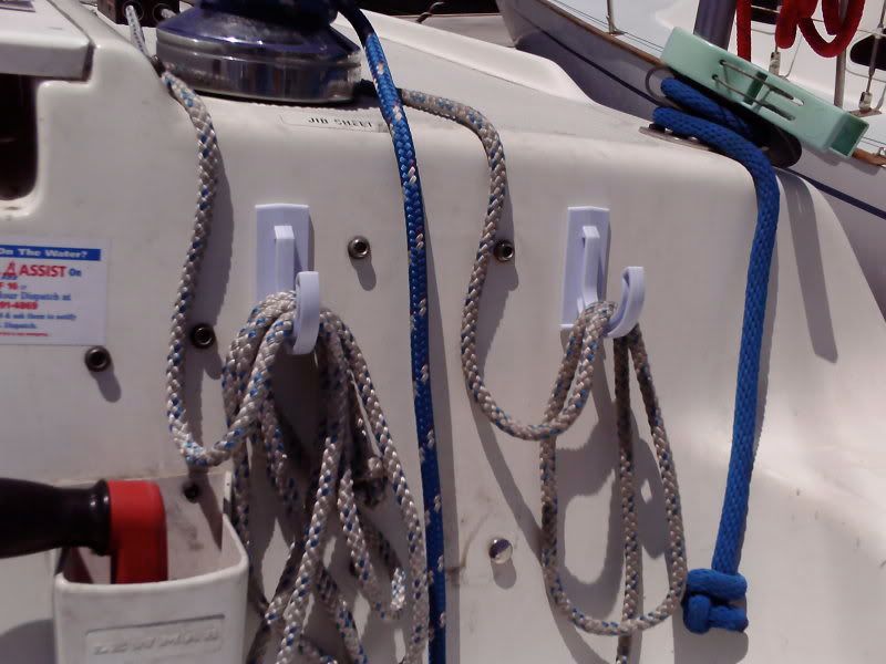

Since the General is not a racer I have all lines to the cockpit for the Wednesday Beer Can Race, which hasn't been any fun lately with the afternoon thunder bumpers and fire works. Here are some pictures.
Starboard Side.
Port Side.
Line holders NO DRILLING. Had to replace them all twice in five years.
From left to right: Furler, Drifter tack, Reef, Jib Halyard, Outhaul.
From left to right: Topping lift, Main Halyard, Drifter Halyard.
From left to right exit boom: Topping lift, Outhaul, Reefing.
Response Posted - 06/16/2009 :  11:34:37  Show Profile
Nice setup! Thanks for the photos, it helps to see how you routed things. I assume that the outhaul system inside the mast is unchanged, correct? Also noted that the outhaul has an additonal line attached to it and I assume that is so you did not have to swap out the line that is already connected inside the boom.
I love 3M Command Hooks too! We have some on the boat, in the cabin, and all sorts of them in use at home. I'm going to look for some of the ones you have, great solution!

Response Posted - 06/17/2009 :  19:43:59  Show Profile
You are correct on both counts. I did add a wire block to the clew to increase the purchase.

Great idea! But to save some bucks, I got these at Target, package of two for two bucks. Bucks saved are bucks earned in this gawdawful economy.
