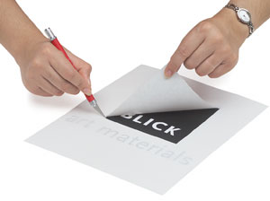

<b>Scratch-Art Wax-O Stencil Paper</b>
A heavy, white, translucent waxed paper that cuts easily with excellent resistance to penetration of oils, dyes, and water-based paints and inks. Pictures, sketches, or designs placed underneath the waxed sheet are easily seen for cutting.
<b>"Stumpy"</b> is an easy stencil because only the "P" has a hole that needs to stay in place.
I would find a font you like print out the name in full size and cut a stencil. You might want to use green masking tape
to secure the stencil and mask out the circle in the "P".
Or you could just use the green tape to outline the letters.
Transfer the letters onto the boat then carefully tape around them.
Pump the boat up till its really hard, clean the surface and paint.
Make sure there are no places where the stencil is lifting up or paint will find its way in and smear the edge of the letters.</font id="navy"></font id="size2"></font id="Comic Sans MS">
