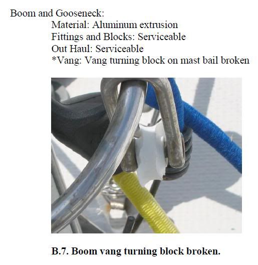

Hello all, another in a long list of inquiry's i am sure. this was noted in our survey report which i got last night. any idea on where i can pick up a direct replacement so i can bring it down with me when i try to sail home? I basically have no idea what size this is... although it looks like a basic piece i could find at any decent sail shop.

certainly the vang is not essential for a safe sail home. In case you are running very deep in rough seas and the boom is sking it is simple to make a preventer with a 10 foot piece of line.
Surely you can buy the block at any West Marine or any sailing shop. Order on line from Annapolis Performance Sailing.

Yeah i dont 'need' it to sail home...I am just antsy to get my new baby all shipshape! I guess ill just wait till i get it home and then take it to a shop to match it up.

Response Posted - 05/05/2010 :  10:51:20  Show Profile  Visit aeckhart's Homepage
What you have is a non-standard, "jury rig" piece of equipment designed by the PO for a specific application. Aside from looking tacky, it probably works well and is cheap since only the roller needs to be replaced. It looks like all the wear and tear on the roller was caused by chafe against the clevis. You can buy the roller at Catalina Direct. The correct block will probably run $40+ but will not wear out like the part you have did.

Response Posted - 05/05/2010 :  17:23:30  Show Profile
I think Al is talking about the vang tackle i.e. using a "D" shackle and small sheave rather than a block. While this might work, it's hard to believe one could get enough purchase to get the vang tight enough without two fiddle blocks.
