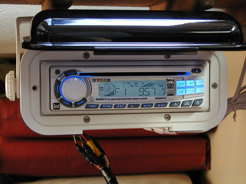

So Saturday I finally spent a day doing nothing but working on the boat. I needed to add a switch to my stereo because if there was electric to it a display light stayed on, so until Saturday every time I left the boat I took the positive battery connection off. Very much a pain. <b>project accomplished.</b> Also about 8 months ago I bought a friend's Humminbird 363 GPS Chartplotter and then a duel jointed swing arm to mount it in the companionway. <b>project accomplished.</b> It felt really good to get some stuff done and I really enjoyed the time spent.

I have a stereo with a light that stays on if I don't disconnect it from the circuit. On my unit, there are two +12V leads, apparently one for power and one for memory. The power lead takes about 1/2 an Amp even if the radio is turned off, while the memory lead takes approx 10 mA, which should have negligible effect on the battery.
When I permanently install it, I plan to keep the memory line directly connected (through a 1 Amp inline fuse) but switch the main power connection using a separate on/off switch like yours, plus a 10A fuse in the switch panel.
The memory line keeps the pre-sets, audio settings and preferences in the radio. If you completely disconnect it, every time you turn the radio on, you have to re-set your favorite stations, your EQ tone settings, left-right balance, front-back fade and subwoofer level.
Not a big deal, but a pain.
Response Posted - 05/18/2010 :  11:48:27  Show Profile  Visit DaveR's Homepage
Yep Bruce, exactly my problem, but a small toggle switch mounted on my outer semi-waterproof box solved that.
