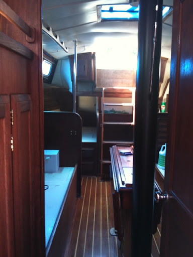

OK, I have spent the last 4 months working on our new to us Ericson 33. We had the boat hauled out at 4 boat units, new bottom paint at 18 boat units, new floor installed at 30 boat units, and the cushions are on the way at 15 boat units. I am working on the systems right now and I need to replace the Par bilge pump, the fan motor on the AC, and 2 new group 27 batteries. The list goes on as I was removing the water from the bilge into the galley sink there was a darn hole in the stainless. The boat is looking better than ever but to all of you 25 owners out there, a bigger boat takes a huge amount of work. I have included some photos of the floor.

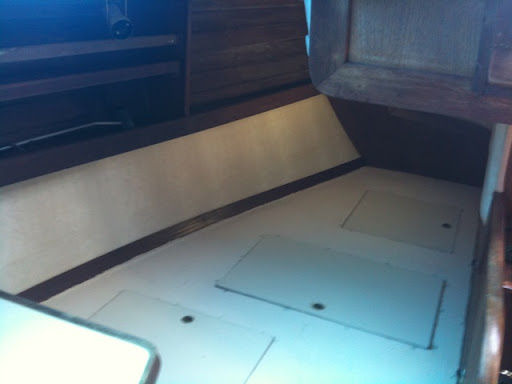

Tom, the floor is 3/4" marine plywood, it has a veneer glued to the plywood that is abot 1/8" thick. The floor was cut to the templates, then we used cedercyde to remove any and all water from the sandwich. This stuff takes all the water out and petrified the wood. We then used thinned epoxy and put 4 coats on the sides and bottom, the floor was then set on the structural grid and screwed down using stainless screws, bungs were cut from a teak scrap and the floor was sanded down, with 4 coats of epoxy on top. We then used a polyurathane to finish the top, another 4 coats, low shean with light sand added in the mix for traction.
Thoughts are when the poly wears down to epoxy we lightly sand and refinish with a new coat.

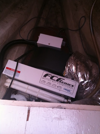

I went down to the boat to clean up the remaining wood and crap out of the floor to keep the area clean, we had a Marine Airr 12000 btu AC unit that was installed in the forward birth, I hooked up the shore power and flipped the breaker and the commpressor kicked on but no blower, the unit heated up then shut down. I have been in the mindset of replacing broken stuff so I located another unit rated at 16000 btu and installed the unit the weekend before July.

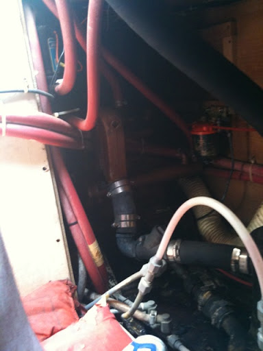

I installed a new bilge pump the following day, its a PAR pump located on the bulkhead at the motor and has a 3/4" line that runs to the bilge and has a strainer on the end. The Water Puppy pump was shot and the wiring coming out of the unit was fused together. I also installed a Water Witch float and am happy of the results. It takes about 60 seconds to remove all the bilge water.

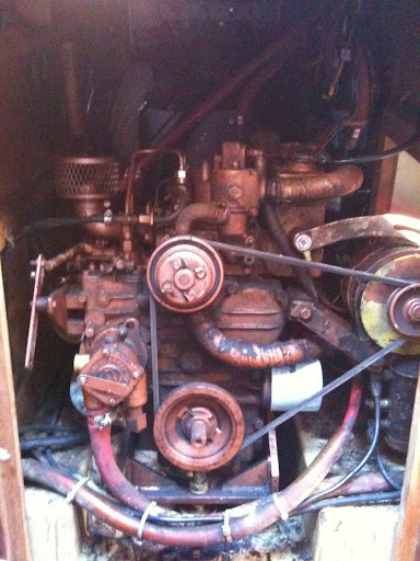

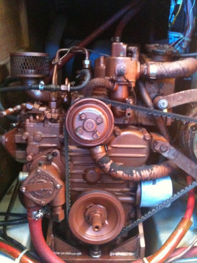

Speaking of Diesel, I took it upon my self and changed the oil, replaced the fuel filter, replaced the belt, and fired her up. Chug, Chug, Chug.... yep it runs great and fired up after 12 years of sitting around in under 30 seconds. The motor was totally a mess when I started cleaning on it, it had so much deisel caked on everything, I spent a good 3 hours with a tooth brush cleaning it.
<b>Before </b>
<b>After</b>

Last weekend we spent another day of cleaning stuff up and I ran 5 vents thru out the cabin to supply AC air, the old unit had 2 ducts with two registers, I purchased a plentium and new duct and teak grill covers and moved stuff around to run air all the way back into the rear v-birth. It cooled the boat down fast - under 10 min in 100 deg weather we were sitting at 75 deg.

That looks suspiciously like a Universal diesel. If you need any help, just holler. Frank Gloss and I had some correspondence about his. You may be interested in this information: http://www.c34.org/wiki/index.php?title=Diesel_Engine
