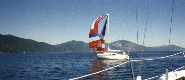

BTW: If you have both of these sails and want to sail on a downwind run, you can rig both at the same time. The drifter on a whisker pole out to one side and the drifter catching the breeze off the jib on the other side. Here's a link to a photo of me (this website's Gallery) doing just this. Notice that I don't have the main hoisted at all. Just the two headsails. The person who took the photo was on a 33 footer that I was easily passing with a breeze of about 3 to 4 knots.
http://www.catalina-capri-25s.org/photo/snickd2.jpg
