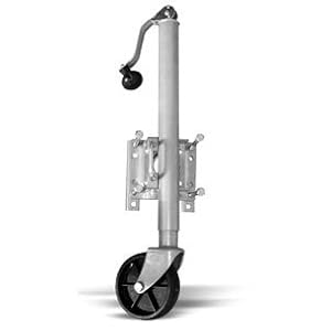

Not trying to hyjack the thread, but I have a question. I do not have one of those spare tire holders with a spinning hub. My trailer has 2 single wheel jacks on the front, one that came with the trailer and another one, new, that I added. Do you guys think I'll be OK using both jacks instead of a spare tire on the front for pulling the boat out using the strap method?

Mark Maxwell
329 Posts
Response Posted - 09/28/2010 :  16:13:36  Show Profile
DavidP
If you are talking about this type,rated 800-1500#
I've seen them used.... and I've seen one break. On that occasion the ramp was very rough and the jack was brand new but under rated.
This one has a double wheel and rated at 1500-2000#
This is another option
Inspect your equipment first. Use at it's lowest height and just go slow.

Response Posted - 09/28/2010 :  19:16:39  Show Profile
What I have is 2 that look like 800 lb jacks. hopefully 2 of them will spread out the load sufficiently. I will go slow. Wish me luck.
