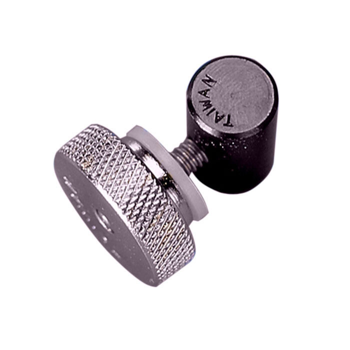

You have 2 options, installing a mast gate (fashion yourself or buy from CD), or install a sail slide stop in the track just above the gate (a small cylindrical piece of metal with a thumbwheel nut attached). I do the latter because I cleat the main on the mast, for now, so I have to go up to the mast anyway. The sail stops cost under $10, available from CD, West Marine, Defender.com, your choice.
The image is from defender's web site:

David;
The track stop is exactly what is both above and below my boom. Since the gate is about 12" above the boom It sounds like you position the stop with one or two sail slugs below it so the bottom portion of the sail cannot fully drop. Am I understanding this correctly.

Welcome Keith! I also used track stops to position the sliding gooseneck. Another track stop can be used above the gate to capture all of the slugs, but the primary disadvantage is that when reefing, you can't get the reef tack as close to the boom as you would want. That's when the gate plates become a better solution, allowing the lower slugs to get as close to the gooseneck as possible.

The track stops make for a really bad reef. I would go with the mast gate. It will allow the slides to get down closer to the boom If a nice neat reef is important to you. I didn't like the way the sail was out of kilter with the stops. It wasn't smooth and showed a lot of stress/pull lines and looked as if this was a good way to tear a sail so the mast gate was one of the first things I installed on my boat.

I have something just like this, and it keeps all my slugs on the mast, didn't cost much either, got it at WM.
It's a good idea to secure a small line to it so it doesn't go over the side when you loosen it or remove it.

Track stops can work, but a gate plate is much better. CD sells them for $45 A little trimming to fit and you'll be set.

Be sure to order the #2350 for a mast with a round sail groove. The #2351 and 2352 are for masts with a flat groove. Look closely at the small print on the Davis track stop pictured above.

Thanks for the info. I picked up a Davis#2350 yesterday before my strong wind single-handed sail. One less thing to worry about. :)

I don't have the mast gate, I use the track stops, and they will go overboard if your not careful. In a pinch you can also use a nut and bolt too. Slide the nut into the track and run a short bolt into it.
