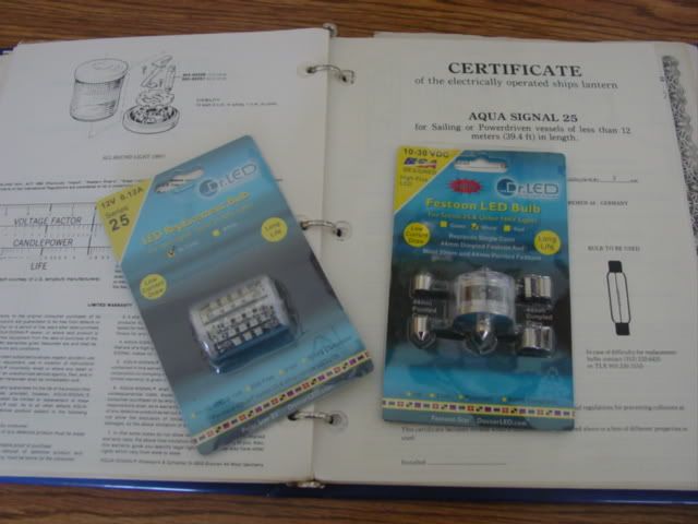

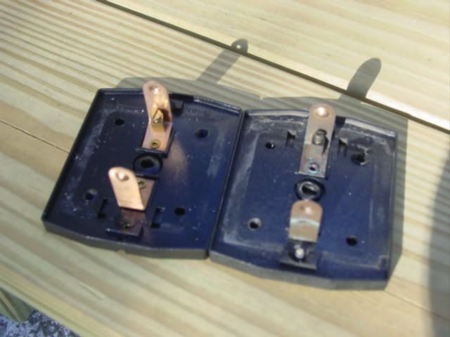

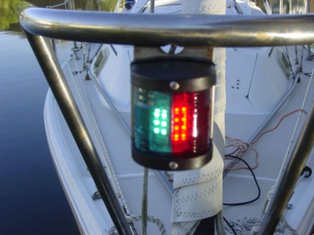

Well apparently only one, but it took 3 1/2 hours, a dremel tool, a trip to West Marine, a vice, a hammer, a punch and a few new words that I made up on the way!!
It all started out easy enough. The goal; change out nav lights to LED.
How hard could it be? Two screws, remove bulb, insert new LED, two screws, done. Not so fast, son of a son of a sailor.
The first problem; the two screws that hold the lens cover to the fixture on the bow light were badly corroded. A phillips screw driver rounded out both screws in quick order.
A dremel tool was called in to grind a slot into both screws so that a regular screw driver could be used.
This plot worked until the top screw broke into two, and then the bottom screw broke the fixture. A decision was made to replace the fixture, the lens was badly crazed anyway, so it was not a big deal. A quick trip to West Marine and the installation of the new fixture was underway.
Until half-way through installation,..... it was discovered that the bulb that came with the new fixture, did not look like the old one!!! Uh-Oh!!
A few new words were added to the English language, and removal began.
The problem was that the old fixture used a dimpled festoon bulb, the new LED bulb also was designed as a dimpled festoon bulb.
The new Aqua Signal 25 fixture came with a regular festoon bulb. The contacts on the new fixture did not come into contact with the bulb contacts.
The fixture was taken to the vice, a hammer and punch were called in, a sacrificial piece of 2x4, a few new words were added to the English language, and the new fixture is now designed to be used with dimpled festoon bulbs. 3 and half hours later we now have LED bow and stern lights to go with the LED anchor light that I replaced last spring, but that is another story!!!

As I related in another thread, the Aqua 25 fixture and the Dr LED lamp [seen on the right in DavyJ's original post at the top of page 1] is not a good physical match.
While it will fit into the fixture, since the top of the mast is subject to lots of violent swinging, the lamp will not reliably remain electrically connected to the fixture, and will easily disconnect from the electrical contacts inside the fixture.
I have looked at a way to fill part of the fixture with clear silicone to firmly hold the lamp in place, but it is at best a KLUGE.
The lamp on the left in the first photo seems more likely to remain connected and stable in the fixture. I would still try to secure the lamp with silicone, double-sided styrofoam tape or rubber cement if possible.
Of course, you should not use any "stickum" directly on the electrical contacts, as this will prevent the lamp working. You'd have to try out several different approaches to make the lamp secure in the fixture.
Think of the forces the mass of lamp undergoes while the boat is waked on the slip or at anchor, or out in the slop and chop.
Edit: Aside from the price, Larry's "all in one lamp and fixture with photodetector" might be the best solution of all.

While it will fit into the fixture, since the top of the mast is subject to lots of violent swinging, the lamp will not reliably remain electrically connected to the fixture, and will easily disconnect from the electrical contacts inside the fixture.<hr height="1" noshade id="quote"></font id="quote"></blockquote id="quote">
Bruce is correct about this. When I replaced my anchor bulb, the Dr.LED bulb looked like the the bulb on the left in the first photo. Apparently they changed the design.
