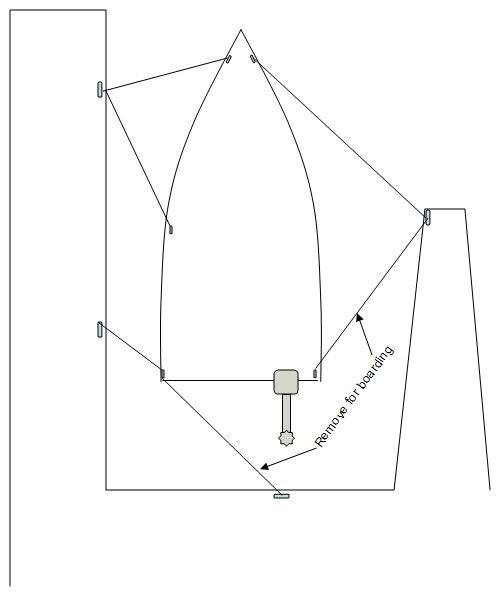

Thanks for all your advice. Today I went to Eastern Marine and returned the 1/2" double braid (all except one that I already used) and bought a bunch of 3/8" twist instead.
Because I was nice to the marina manager last year, she gave me the only single slip in the whole marina in my size range (just inside a T-dock). So after relying on fenders all last year, this year I should have enough cleats to keep the boat from rubbing the fenders, although I'll probably leave them out just in case:
