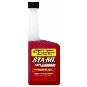

It's a great idea to run the excess gas out at the end of each outing, doesn't matter who's engine it is. But especially when you're putting it away for the winter. Then either put the recommended amount of "sta-bil" or like gas treatment in whatever fuel you have in the tank or pour it into your car and get new fuel in the Spring. And as far as the impeller goes I haven't seen one fluctuate like that, only when you increase or decrease the throttle. How long has it been since you replaced it?

There might be some differences between the best practices for 2-cycles (Johnson/Evinrude) and 4-cycles (Honda and others)... But a Honda mechanic recommended that I double up on stabilizer in the last fuel of the season, run the engine to get the stabilizer into the carb, turn off the engine (carb full), fog the cylinders, and put her away. The theory was that an empty carb has residual gas that dries into varnish on the float valve and jets, while stabilized gas will remain fluid until new, fresh gas is run through next spring.
I followed that advice with my Honda 8 using two stabilizers--Marine Stabil (green version) and Startron, which are significantly different chemistries. It seemed to work, but I can't say if it worked better than if I had run dry, because I didn't. My Honda 225 (the Pilot V-6) has gas in the injection system all winter--I don't think there's a way to run it dry except to run the 110-gallon tank empty (which I don't). But that's obviously a "different" engine!

On all my engines I run them dry if they will not be used for more than a month. If they are used more then that I don't bother running them dry. My thought is the more gas left in the bowl the more gas to go bad. I always add some Stabil to any gas that will be in the tank more than a month. That way if any gas is left in the carb bowl, after I run it dry, the Stabil helps to keep it from drying into a pile of goo. If your worried about fire danger from disconnecting a fuel line you can disconnect it before you start the engine. There is a drain screw on the Tohatsu carb located on the port side of the carb bottom cover. Not sure if you can access it without removing the carb.

I just disconnect the fuel at the engine end and run it till it dies. I did the same thing with my two strokes and never had a problem. Stabilizer will not stop the fuel from evaporating and leaving a residue.
