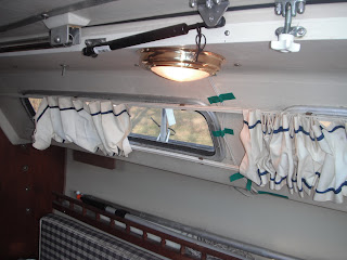

Alex...I replaced all of my fixtures last year with the ones from [url="http://www.catalinadirect.com/index.cfm?fuseaction=product.display&product_ID=1941"]Catalina Direct[/url]. I paid a premium for them compared to what else is out there, but so far I'm very happy with them. The color is good and the light output is very good.
Here are some pictures....taken at night....with my iPhone...no flash....so the quality isn't very good but gives you an idea of how good they are: (They look much better in person)
