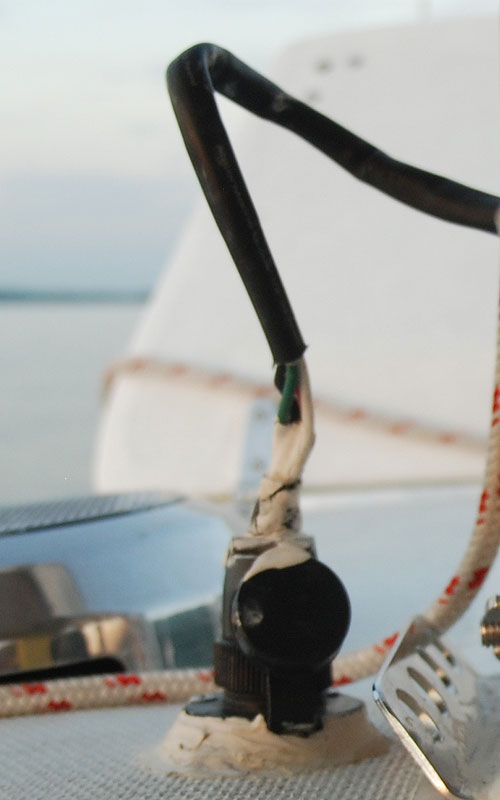

I installed a new through-deck connector last summer when I changed the anchor light LED bulb, added a foredeck light, and replaced the steaming light fixture. Since then the pins became dirty and I scraped them off to re-connect the mast light circuits, maybe three times.
Now the pins seem to be loose and do not connect properly unless they are inserted half way and tilted a bit. :Last weekend I taped the connector like that using duct tape. Hurray for duct tape!
Is a reasonable fix for this problem the use of "electrical conductive grease", which would fill in the gap between the pins and the sockets? I've never used that stuff, but it is sold on the web and probably in some stores.

Is there some other easy fix for these connectors?
I really need the steaming light and the anchor light to be reliable, since I am out in the boat at night frequently.

Ya know John, In my mind it seems like the only way to keep the deck connector decent is to take it out of the deck. Seems like the weight of the wire coming off it above causes problems, or maybe they're just cheaply made. But I agree, they don't hold up too well.

Yepper .. John that conductive grease would probably be my choice, but it will not hold up if the deck connection can get moisture down into it. Usually saltwater running down the line connector.
I used the Catalina Direct deck connector and I really like the design.
Good solid screws and capture holes.
http://www.catalinadirect.com/index.cfm?fuseaction=product.display&product_ID=205
What you want is a good tight connection to the wire, by grabbing the wires with a big set of pliers and twisting the wire really well and then cut the wire off flush. Put some grease on it and push it into the capture hole and then tighten down the screw tighter than you think. Put polysulfide on the wires and screw down the fitting cover, and then push polysulfide into the outside of the wires at the sleeve..
Your polysulfide "calk" is also attempting to keep everything from moving as well as seal it.
ANyhoo.. that's what I did and I'll let you know how long it holds up.. It you are wiring for the first time leave extra wire to give you room to rewire the fitting every few years. Mine is Ugly, but it is working now.. and yepper.. you need it to work. New mast wiring harness from CD going into the fitting from the top.
New 14-4 coming in from the bottom
And yepper... I'd put that grease on the pins.
