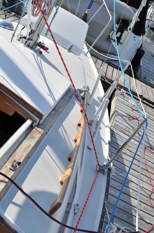

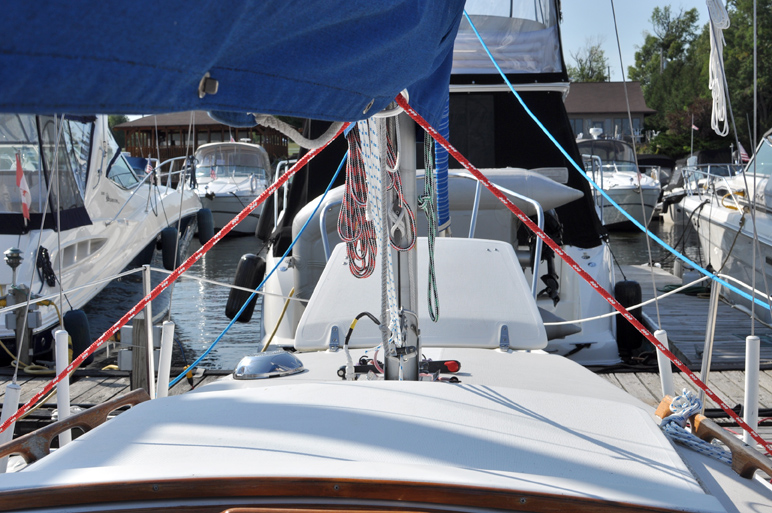

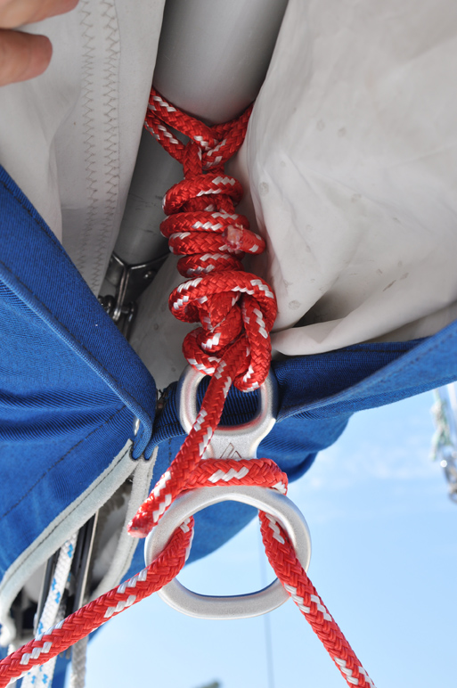

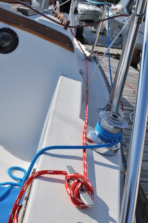

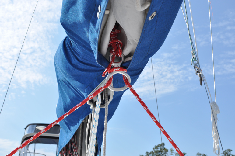

i made an inexpensive boom brake and it works quite well! (i didn't invent it, i got the idea online) with just a rock climbing "8"
i tightened it by hand on the cleat and gybed the boat and the boom wouldn't move! it's an easy install since i just attached the "8" with a piece of 1/4" rope but you could put a second boom vang hound to attach it... and two blocks to the stanchion bases (the boom brake can also work as a boom vang!) during a gybe you just have to loosen the line a bit and the boom will gybe slowly to the other side!
all i needed was 48' of 1/2" line, 5' of 1/4" line an "8" and two blocks!
here's the "8" i used:

If you can't use the genoa track you could also route them to the inside of the main chainplates. It looks like the routing would be better too and keep them out of the way of the handrail.

i guess one could easily put a shackle with a block on the remaining hole in the main chainplate but i'm not sure about it's resistance to a sideways force, i guess the pulling force of the shroud would absorb some of the shear force?
anyway the force on the boom break isn't that strong, i think the boom will fold before the stanchion will rip out (remember that the block is attached at the base so there's no leverage force on it, you could technically cut the stanchion above the block and it would become a "deck organizer"
i tried to manually pull on the boom while the brake was applied (before trying it for real) and the boom was bending a lot, if i'd push harder it would break...
