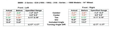

Not so bad after an eyeballing job. I did the same thing at 160k miles, but since it was a rear wheel drive bimmer, there were differences. The strut assembly is reusable and the gas tube just slides in after compressing the springs a bit. But to get the brand new tight feel, all the rubber was replaced requiring dropping the subframe and bolting on new steel with the bushings already pressed in. Turned an old clunking suspension into showroom fresh. Nice you didn't have to use a spring compressor. Pretty scary on the cheap using the large screw type with cast aluminum claws.
