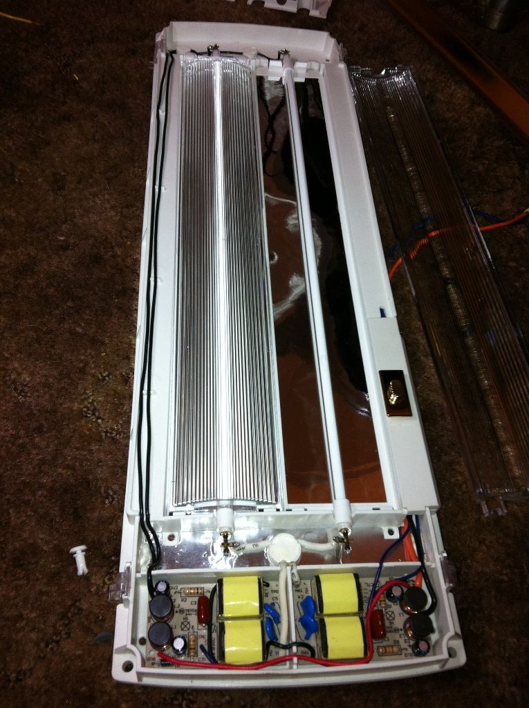

I just got a Talyorbrite Cold Cathode Fluorescent (CCF) lamp fixture from the clearance rack (likely because it was a 24V model). The color is not blue but regular lamp warm, it claims 25,000h life, absolutely no on/off wear (works like a neon lamp) and the fixture is marine grade. I called Taylor and they have eight available, but 3x the price I paid. The reason for discontinuing this awesome product was the extraordinary cost to manufacture as LED's progressed. I'm still not sold on LED's producing welcoming light, so I may save up for another CCF lamp (the one one with red and white will complete the list).

<b>Cold </b>cathode fluorescent, my friend. There is no filament on either end to heat up and wear out. There are just single electrodes at each end. Same tech as flatscreen TVs and laptop backlighting ( before they too went LED).
Two inline ammeters measured just 0.6 A running both, my rat shack meters don't provide inrush and I cheated by skipping over the 12-24V converter. But talk about Holy 22 AWG to light an entire yacht... well, I guess LEDs do that, if you're the type to enjoy sterile blue tinted highly directional point source lighting.

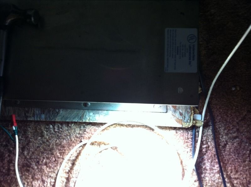

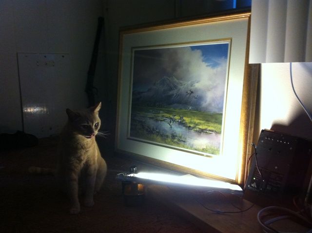

Ever since I saw a reef aquarium shimmer under an HID light, I've wanted the the same for my home. Well, I got lucky a few days ago thanks to Jimmy Carter's H4H thrift store and my dream came true. Likely pulled from a millionaire's pool. It's fiber-optic driver, a box with ballast, fan, a very nice 85CRI 150W HID projector bulb and a 3 color rotating filter. Normally dozens of fiber optics distribute the 10k lumens gently but I did a little mod and now nothing is between the bulb except a UV filter. Wow! The power of ten regular light bulbs lights emanating from a 1/2" bulb is pretty close to having a mini Sun. The fan is noisy and even a quick glance at the lamp it is worse than looking at the sun because you aren't already outside (in a scientific laser lab, the rule is to keep the room bright so eye damage is minimized).
