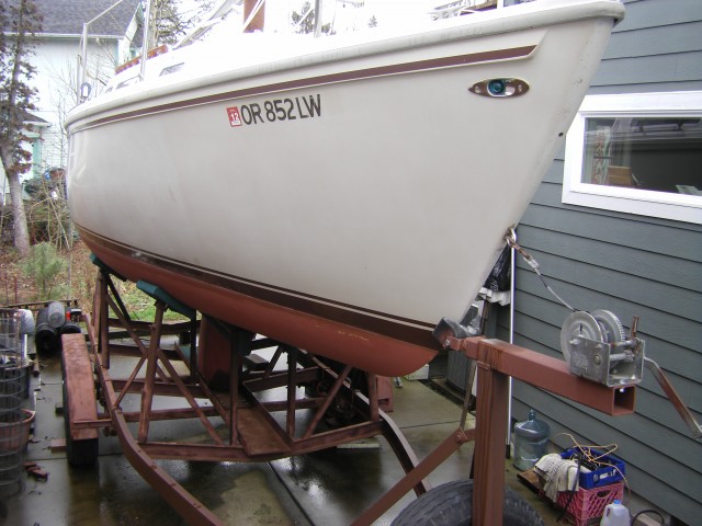

I have a 1978 C-25 FK on this home made trailer. If I were to do it again, I might have been more inclined to purchase a swing keel boat. I hear that they are not as fast as a FK, however are much easier to trailer. With North Texas Lakes water levels being so low, in the event that you hit the muddy or rock bottom, you can crank up the keel and get out of that mess.
The axle on my home-made trailer looks to be very HD, however I would recommend that if your boat don't already have a trailer specifically designed for it (ie: from the manufacturer), I would definitely recommend a dual or triple axle configuration (like Chuck has). I intend to modify my trailer with a dual axle or triple axle configuration in the very near future. I dont own a truck, so I go to the local U-HAUL where I rented and pulled it with a Ford F250. I drove very slowly (35-45mph) on back roads to get her from the P.O.'s back yard to the sailing club (about 70 miles). My trailer has NO brakes so going faster or on the freeway was not an option (in my mind). I had no issues pulling her but I would REALLY feel more comfortable with a second axle and more tires on the ground.
I am also not sure about the load capacity of the tires that the P.O. had installed on this trailer. They always look about half full (or half flat) even though they have about 10 psi more than the tire is rated.
I haven't launched her using the local boat ramp because I need to fabricate a tongue extension that will push the boat into deeper water making it easier to launch.....and keep the truck out of the water.
I have also been doing all sorts of fiberglass repairs to the keel and to the deck. It just seemed prudent to have all the work done while she is dry.

Kyle, that is almost my sister trailer. I've yet to see a similar construction steel girder tandem trailer (search forums for my photos). It's a 1 ton trailer. Trailering is expensive with new tires needed every 7-years regardless of use, bearings to be packed, brakes to be maintained. That 10' launch extension is usable to launch (or fling) the boat into the water. Retrieval onto the pads with bow to stop is done more gently with the keel strap method; otherwise either your truck is getting wet or the boweye is given a yank.
Kper
417 Posts
Response Posted - 03/30/2013 :  02:26:54  Show Profile
rrick, Are you saying the trailer is insufficient for the weight of the boat?

I meant the trailer itself weighed 1750 # without the boat! Everything feels overkill until I noticed the 3500 # axles cuts it close for a loaded Catalina 25 FK.
