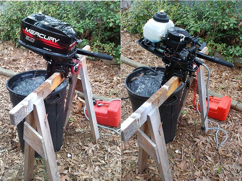

Or maybe something like this happened to you:

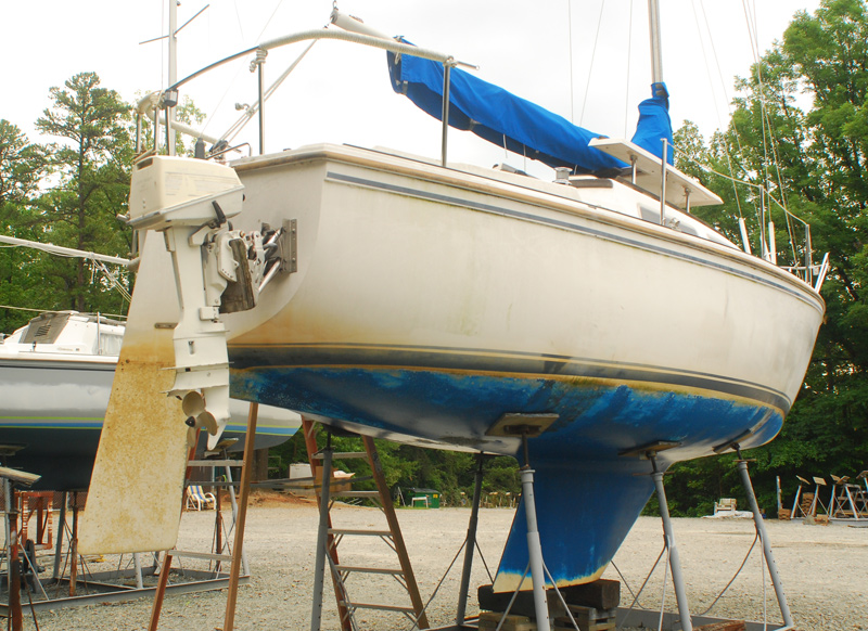

Like for me...Mine is: Shirley is a 1984 Johnson Sailmaster 6hp two stroke OEM for Catalina 25s that is in the garage right now about to go to the shop for a tuneup after 5 years as starting first or second pull everytime. I pulled the thermostat out of her last year cause we just don't get that cold down here. A flat three blade prop pushed her pretty good from the word go but she is slow at cruse speed. She has the smoothest shift I've ever seen and she stays in gear. I pulled her cause she seemed to be runnin a little hot and I was worried her water pump is getting old. THe boys at the shop did a good job with her last tune up ( 5 years ago ) and I've changed out the oil in the foot once, cleaned her cover and reworked her gasket on the cover, changed out the rubber lines on the water pump and changed out the plugs once. Shirley will surely start and run every time.
I've checked to make sure her back up shear pin is shiney ( and I can find it ) about every year.. and we normally kept one taped to her with electrical tape but that one is gone.
I've got two cans of starter spray on board but she has never needed it.. I put a new starter rope on her last year, but I'm not real happy with the looks of the new rope so I don't think it will last over about 5 years. She got a new tank and line and bulb 6 years ago. I keep an extra bulb on board.
Shirley likes the choke on start and then pretty quick no choke. She does not like to run rich.. lean her out a little makes her happy. I keep promising her I will get a Dive knife with a lanyard on board in case I need to jump off and cut her prop free from fishing line, but I haven't yet, so I will probably end up trying with a kitchen knife and drop it, if it does happen..
