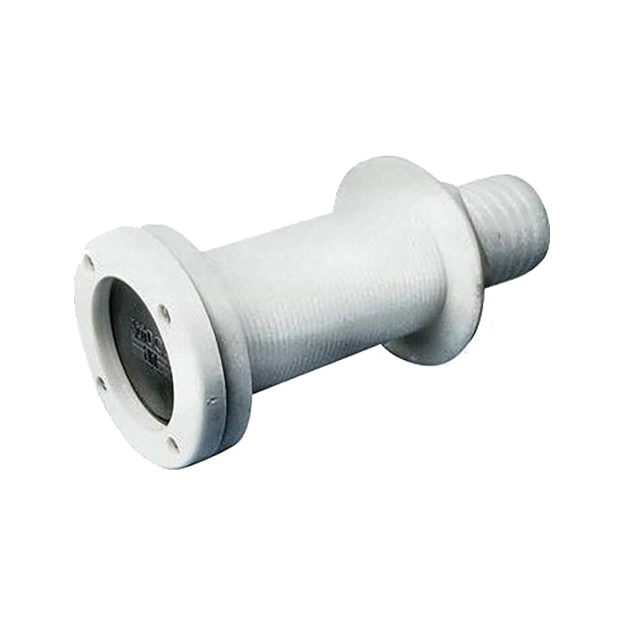

Anyone know what size the original brass scuppers are? they look bigger than 1" OD... maybe 1.5" OD?
I am thinking of installing THESE instead(tinyurl to defender part):
http://tinyurl.com/ln97zbr
I am thinking of cutting the whole thing to size, it'll be easier if I don't have to reside the hole in the transom to do so. The reasoning about using these, is they have the built in flap for 1 way water flow. When you boil downwind in the Capri, the scuppers flood, seems upgrading to something that prevents that makes sense. thoughts?

Ok, I got a question for the brainshare here. I removed the brass scuppers, and found a nearly 100% intact board laminated in the stern... there are tiny holes (probably air spots) less than the size of a pea in the "tunnel."
My question is... can I just coat the whole tunnel with Interlux Watertite Epoxy, fair, and be done, or do I need to add fibers to strengthen? The scuppers I bought are at least .5" bigger than the hole, and I can grind it all out (and I have to a point), but there isn't enough room in the pit to put the nut on the pipe. I think these scuppers are designed to have a hose connected to them that works for 90 degree type scuppers.
My thoughts were, to glass/epoxy up the holes, and put JUST the flappers from the new seadog scupper on. This should keep water from rolling in while surfing downwind.

Response Posted - 01/05/2014 :  09:32:48  Show Profile
I think the best solution is just where you are at today: use un-thiickened epoxy to saturate the core, filling in then with thickened to build up as needed. Radius the entrance and exit bysanding when fully set and voila! If you can't fit the flapper valve, there are stainless alternatives available as well. Better yet, use ketchup bottle lids mounted on a hinge!!!

Wow. That is considerably different from what I had. So you have a board laminated in on each side that fills in between the transom and the rear of the cockpit? I have about a 4" void in between, bridged by the brass scuppers. There was obviously something there before that rotted out, but I didn't think it was that substantial.
Response Posted - 01/05/2014 :  19:08:14  Show Profile  Visit shnool's Homepage
It's probably about 2" deep.
Yep, I'll use an epoxy, with a thickener, that way I can shape it some... the flappers fit, but I LOVE those Heinz 57 lids.. freaking cool find!
