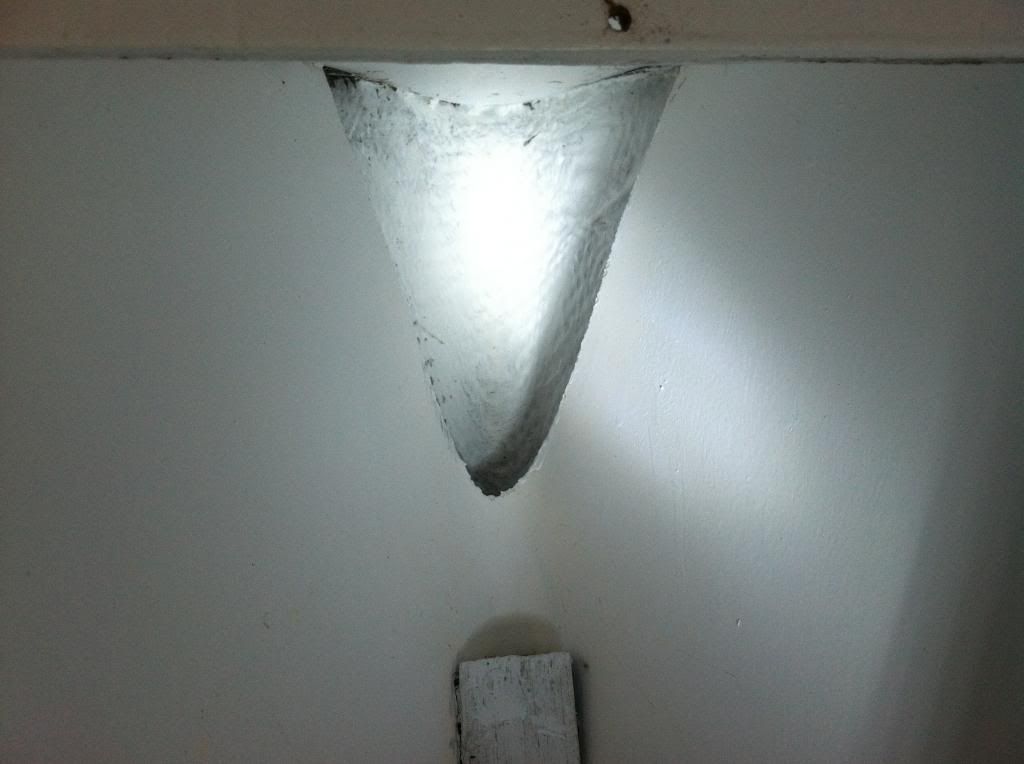

Recently I asked about a problem I was having with water in my v-berth. As I contemplate my repair though things just seem wrong. I am trying to figure out what is going on with the nose of my boat on the inside. It might help me if someone with a similar vintage boat (78) could see if your nose looks similar to mine.
From the outside of my boat everything looks fine to me. No signs of any bad repair jobs by previous owners. But from the inside, the nose of my boat looks like someone did a slapdash repair.
I hope this picture communicates what is going on.
To get here I just popped off the decorative hatch towards the bow of my boat in the v-berth. What seems to be going on is the fiberglass on the inside walls of the boat go forward but then end sharply about 4 inches from the very nose end of the boat. It looks like there must also be an outer wall of fiberglass that forms the outside wall of the boat. I can actually put my fingers into this gap between the inner and outer layers of fiberglass. It's messy. There is a dark grey substance all over the inside of the outer wall. Whatever it is, it looks like someone has smeared some of the excess of this material on the sides of the inner wall.
Above all of this is the anchor locker. This strange ending of the inner wall continues up there as well, though it seems more effort has gone into filling in the gap between inner and outer walls. Here is a picture of the anchor locker.
The ending of the inner wall is less obvious here in the anchor locker but it occurs where the colour of the side walls turns darker. Towards the top of this seem I am again able to put my fingers in between the two walls of fiberglass.
Also in this photo you can see the focus of my concern: The water pooling in the front of the anchor locker. Is this drain system normal? It's just a hole straight through the hull to let water drain out.
My main goal here is to stop water seeping into my v berth. I'm wondering if I need to do more than just get the water pooling in my anchor locker to flow out. I'm wondering if water is getting in through this seem between inner and outer walls of my hull.

I have a 78 how did you take this picture? was it through the anchor locker. Not sure how you got this view but if you tell me,Saturday morning I can snap a few pictures.
indecentseas
67 Posts
Response Posted - 03/11/2014 :  07:41:01  Show Profile
stang,
Upper picture is taken inside the boat at the very front. At the bow end of my v-berth is a wall with a removable hatch. The hatch is decorated with an anchor carved through it. I removed the hatch. The picture is what is what is fore of that hatch. The lower photo is simply the fore area of the anchor locker. I popped the anchor locker open and took a shot of the inside, looking forward. I'm really interested to know what both areas look like on your boat. My current thinking is that the upper photo of the inside of the boat is largely original with a bit of grey muck put in to slow leaking. I suspect the upper photo of the anchor locker is not how the boat was built. It just makes no sense that the drain for the anchor locker could be so poorly positioned.

Thanks for the photo, Stang. Very helpful. It looks like the structure of my nose is the same and that all that grey stiff was slapped on in an attempt to stop a leak. So my final question on this is: Is my anchor locker stock? Stang, (or anyone with a similar vintage) what does your anchor locker look like at the nose? Is the drain (as it is on my boat) about an inch above the low point of the anchor locker? Does the drain flow forward out the bow of the boat?
Thanks all.
Response Posted - 03/17/2014 :  16:06:30  Show Profile
indecent: I think yes, yours looks stock. Use a wire or something thin to clean out the drainage hole. Once it is draining freely, you may not have leaks. I forget which owner posted a great article, on anchor locker rebuild...
