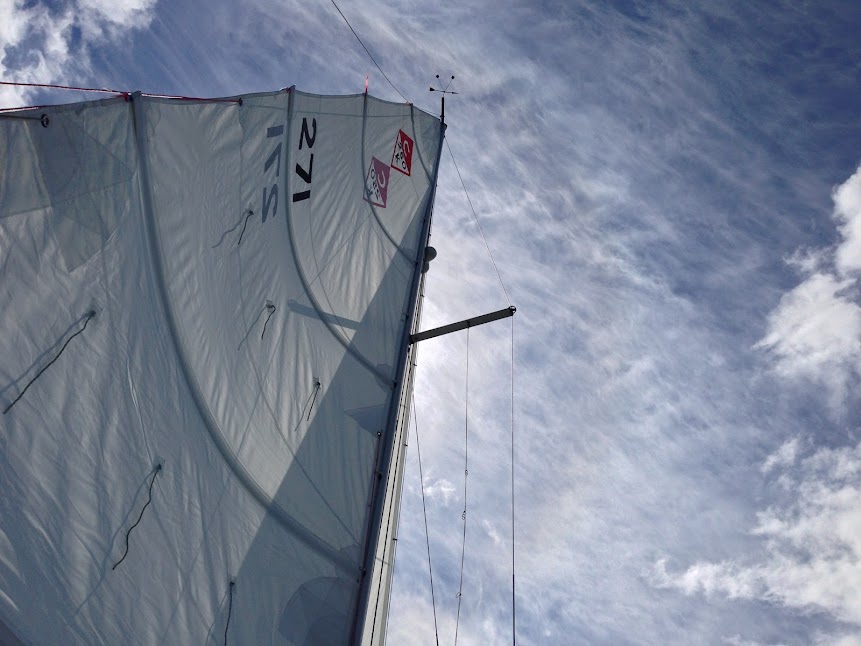

The radar reflector is permanently mounted to the front of my mast about 20' up from the deck-ish. It's a tri-lobed Luneberg lens, I've probably got a picture of it somewhere.
The jib & spinnaker halyards both like to hide behind the two rear lobes and won't pop out without some coaxing, which is the last thing I want Rita to be doing while standing on the foredeck (she goes forward much more often than I do). I think I could add a downhaul for the jib to keep tension on the halyard and keep it away from the reflector completely.

You can see the radar reflector about 2/3-3/4 the way up the mast here, just above the spreaders:

If the reflector is like [url="http://www.tri-lens.com/trilensweb12002002.htm"]this[/url], then how about making a Sugru string that stretches from the outside most part of the rear bulge down to the support bracket.
That way the line would not get caught behind the lens and the lens could still be removed if needed. No impact on the mast.
Response Posted - 05/20/2014 :  21:28:20  Show Profile  Visit delliottg's Homepage
Yep, ours is the middle sized one. I thought about a thin plywood ring around the lens, but I'd have to drop the mast to do that. I think I can prevent it with a down haul. I'll give it a try over the weekend.
