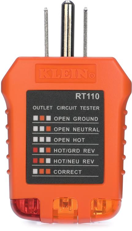

I did not leave the power on for more than a few minutes, time to check each plug with the 'circuit tester'.
The tester is a simple plug-in one.
http://www.sweetwater.com/images/items/750/ReceptTest-large.jpg
As in this one, the bottom 2 lights came on.
So, it seems the recepticles are ok.
