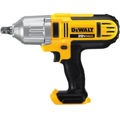

One of these will help speed up the tire changing process if you have to do it on the side of the road.
You may have to use a breaker bar or lug wrench to loosen them slightly but this will make it a NASCAR pit stop after that.
http://s7d9.scene7.com/is/image/murdochs/Dewalt-9866073-DCF889B-main?$product-zoom$
Just be sure to use the lug wrench to do the final tightening after changing the tire and running the lug nuts back on with this.

Hey, that's a cool tool, GaryB. I'll have to save my pocket money.
