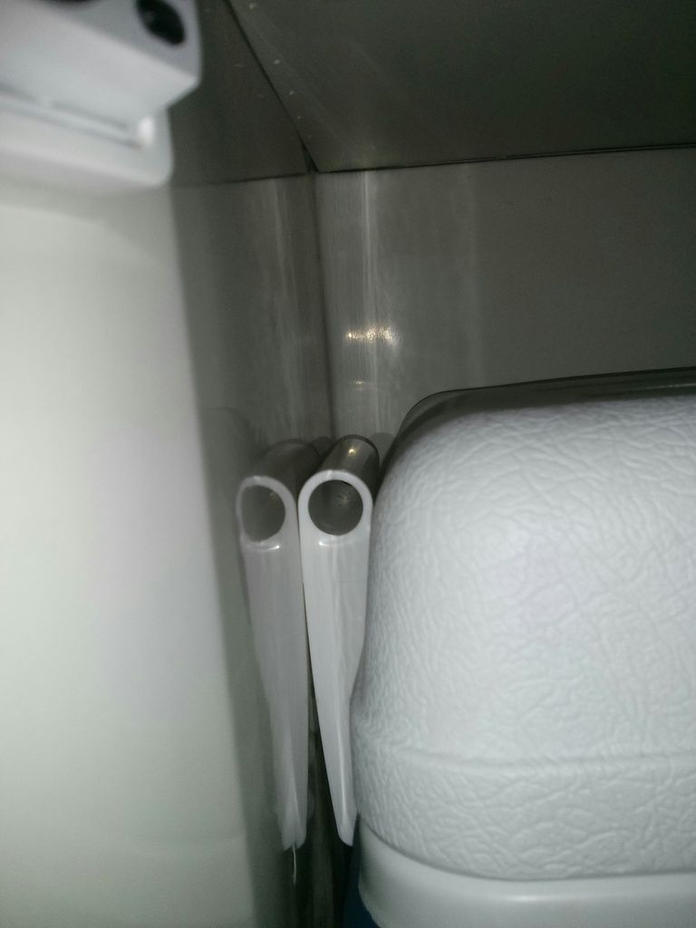

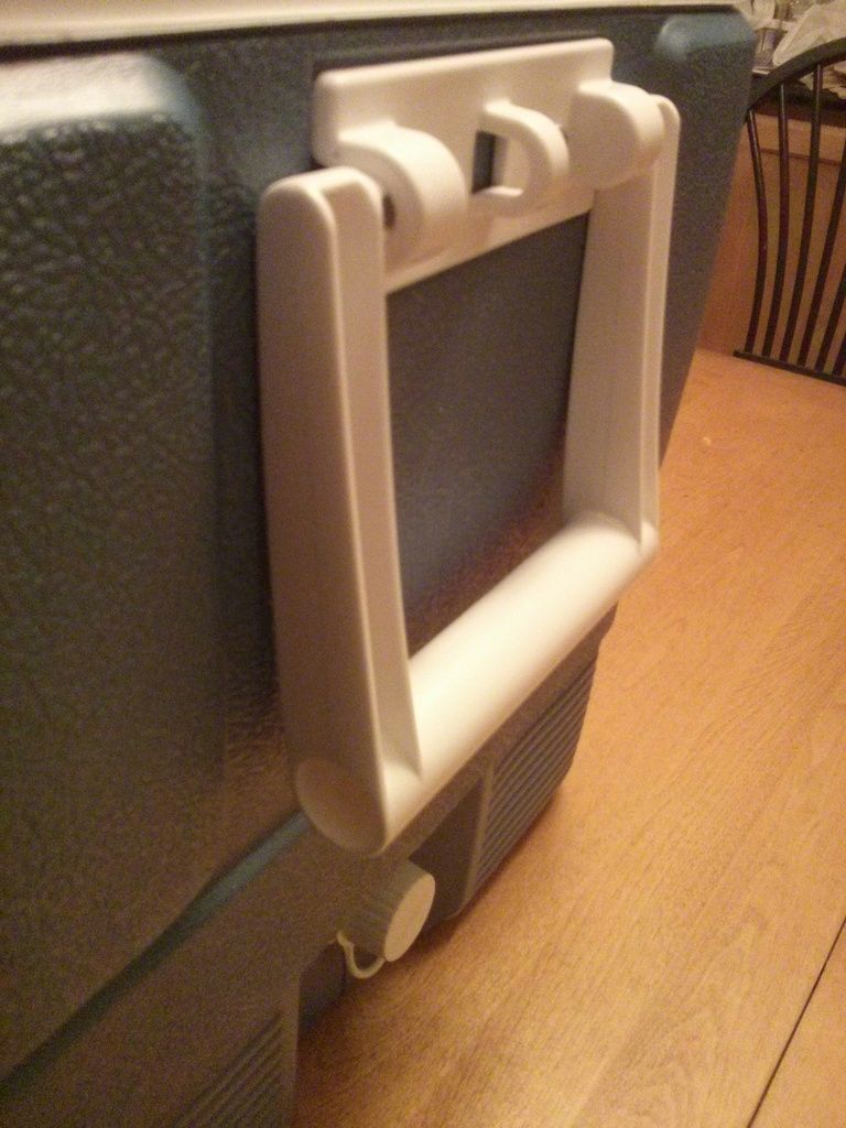

The answer is, all the numbers for the width are are right, and wrong. The width of the box itself is about 24", from handle bracket to handle bracket is 25.5", and from the outer edge of the handle to handle is 27.5". But there is a trick: If you remove the handle brackets and re-mount them upside down, then when they are raised they are exactly 25.5" wide and will fit in the galley space. The handles are curved so that they fit the contour of the cooler when they are down, so when you mount them upside down they stick out a bit in that position. But when the reversed handles are up, they are more compact against the lid and therefore fit within 25.5":
I should mention another "trick" that some have used is to re-mount the handles in the front and back. That would make the cooler fit even better, but I'm not willing at this point to poke new holes in the brand new cooler.
As far as the depth goes, you can push the bottom back far enough to get it behind the bottom lip, but the cooler is tilted slightly forward when you do so:

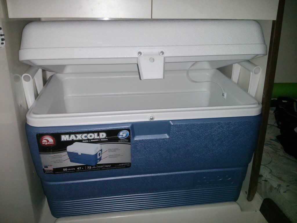

The cooler is higher than the stock Coleman cooler, but you can still open it far enough to fetch a drink. Or you can slide it out to open the lid further:

The cooler definitely fits in the galley area, but it is very tight. You can open the lid a few inches to grab something on top, but if you want to rummage around inside you need to pull the cooler out onto the floor. And, like any cooler, if you pull a large item from the bottom, something from the top will always fall into the hole. Then if you want to put that large item back, you need to pull a bunch of stuff out to rearrange everything. The result is a lot of lost chill, especially if you're doing this in 90+ degree heat. I might try to make some dividers to prevent this from happening in the future, but that's way down the list.
