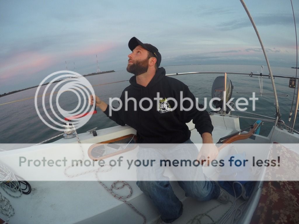

Speaking of self tailing, the lady snapped this photo tonight of me doing exactly what I mentioned.

Response Posted - 10/29/2015 :  20:37:28  Show Profile
Good on ya, mate... But I never imagined getting the winch handle out in that kind of flat water. Then again, I didn't have self-tailers...

sometimes if I wanted to harden the genny a little more on a beat and couldn't easily do it by pulling, I'd luff up for a few seconds and give it a yank.
Like Dave this is how I do fine adjustments. In the 6 yrs of owning my boat I have NEVER had a winch handle in those winches. Never saw the need. The only place I use the winch handle is on the cabin top winch to tighten up the main sail luff the last inch or so to remove any wrinkles then it becomes a useful hanger for the coiled main halyard. I suppose if you race you wouldn't do this. Most of the time I can haul all the line in on a tack, Set my course then slacken the line to tune the sail.

Response Posted - 10/31/2015 :  19:37:22  Show Profile
Light wind, selftailers should have another wrap. Remember the friction of the drum is holding in the sail, not the striper or the jaws.
