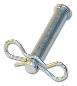

 hairpin cotters instead of ring or straight?
rbpc25
86 Posts
Initially Posted - 07/08/2016 :  09:13:48  Show Profile
hi all
does anyone use hairpin-style cotters instead of standard cotter pins or rings on various parts like turnbuckles, lifelines, celvis pins, etc?
rings seem safest, and least prone to snag, but I like the ease of removability of the hairpins (also a disadvantage, of course)
are there any other cotter styles out there?
lastly, anyone know a good source for split-ring Ronstan-type cotter rings (decreasing diameter)? I have been searching everywhere, but not found a good source - most seem to be parallel-diameter style - I find the Ronstan-type much easier to install
thanks!
Rolf in MA
C25 #4959
Edited by - rbpc25 on 07/08/2016 09:24:36
rbpc25
86 Posts
Response Posted - 07/08/2016 :  09:17:56  Show Profile
and what about 'rue' rings?
Rolf in MA
C25 #4959
rbpc25
86 Posts
Response Posted - 07/08/2016 :  09:26:03  Show Profile
check out the 'bowtie'!
Rolf in MA
C25 #4959
Response Posted - 07/08/2016 :  11:01:22  Show Profile
http://www.westmarine.com/buy/west-marine--cotter-ring-kit--251754
Response Posted - 07/08/2016 :  11:19:46  Show Profile
The hairpin is easiest to remove and snag, and therefore the least secure. I used them for things like my day sailer rudder pintle. I'd never use it for standing rigging. On open-body turnbuckles, I used straight bronze pins and wrapped the tails around the body. I used rings on most clevis pins. It's security vs. ease of removal. I haven't tried the rues.
Edited by - Stinkpotter on 07/08/2016 11:29:37
rbpc25
86 Posts
Response Posted - 07/08/2016 :  11:26:53  Show Profile
understood, thanks guys
I have also done SS wire, through T-bolt hols, and wrapped around body - thoughts?
meanwhile, I will stick to the split-ring Ronstan-style, unless the bowtie turns out to be equally secure (I like that it has a longer lever-arm to prevent turning of the turnbuckle)
Rolf in MA
C25 #4959
Lee Panza
468 Posts
Response Posted - 07/08/2016 :  22:10:09  Show Profile  Visit Lee Panza's Homepage
Rolf, here are a couple of sources for the easily-removable cotter rings:
http://www.downwindmarine.com/Cotter-Pins-amp-Rings-p-1-c-6248.html
and:
http://www.westmarine.com/buy/west-marine--stainless-steel-cotter-rings--P002_060_010_004
The hairpins are OK for things that need to be frequently or easily removable, but they would be hazardous in most applications on a sailboat. Any kind of easily-removable pin - including cotter-rings - need to be used with caution and checked regularly. I use cotter-rings to attach my shrouds, because I drop my mast from time to time, but I've had them snag on the jib sheets and have had to replace one now and then. I use them at a lot of other places where they aren't subject to snagging, but I check them all from time to time because I had one nearly wear through (they are thin wire, after all). Just be cautious with them.
The trouble with a destination - any destination, really - is that it interrupts The Journey.
Lee Panza
SR/SK #2134
San Francisco Bay
(Brisbane, CA)
Edited by - Lee Panza on 07/08/2016 22:26:39
rbpc25
86 Posts
Response Posted - 07/09/2016 :  11:50:36  Show Profile
I have sometmes used SS wire for my turnbuckles, b/c 1) I can choose the guage/thickness; 2) I can cut to size; 3) I can tuck the tails into the turnbuckle, so nothing's snaggable; 4) it's cheap
any reason not to keep doing that? what is standard turnbuckle practice? cotter pin? and is that b/c it's thicker guage than a cotter ring, or wire?
wouldn't a bow tie be even thicker than straight pin, and less snaggable?
Rolf in MA
C25 #4959
Edited by - rbpc25 on 07/09/2016 11:51:14
