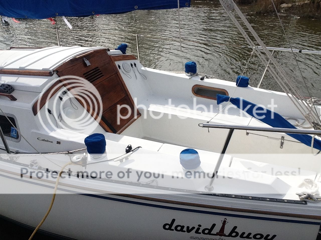

Response Posted - 09/01/2016 :  06:18:55  Show Profile
Originally posted by TakeFive
A pressure washer is good for really rough surfaces that would tear up a sponge (sidewalks, driveways, stucco) or difficult to reach places (hull below the waterline, high-up windows). But for many things a sponge or brush is better.
Remember though, the 15+ extra years of sun and environment exposure most of our C25s have been through can make it quite a bit rougher. I've cleaned by hand and by power each a number of times and between the different types of sponges, brushes and scuff pads you need to get everything out of the gelcoat becomes crazy.
Im sure if i cleaned, sanded, compounded, buffed, waxed, etc.,etc. then keeping it clean with a sponge would be pretty easy. I really don't have the time and energy for that though, and don't foresee that happening anytime in the remote future. For me it's probably going to stay a twice a year powerwash with occasional cleanings/hose offs. I think the results are blinding..
