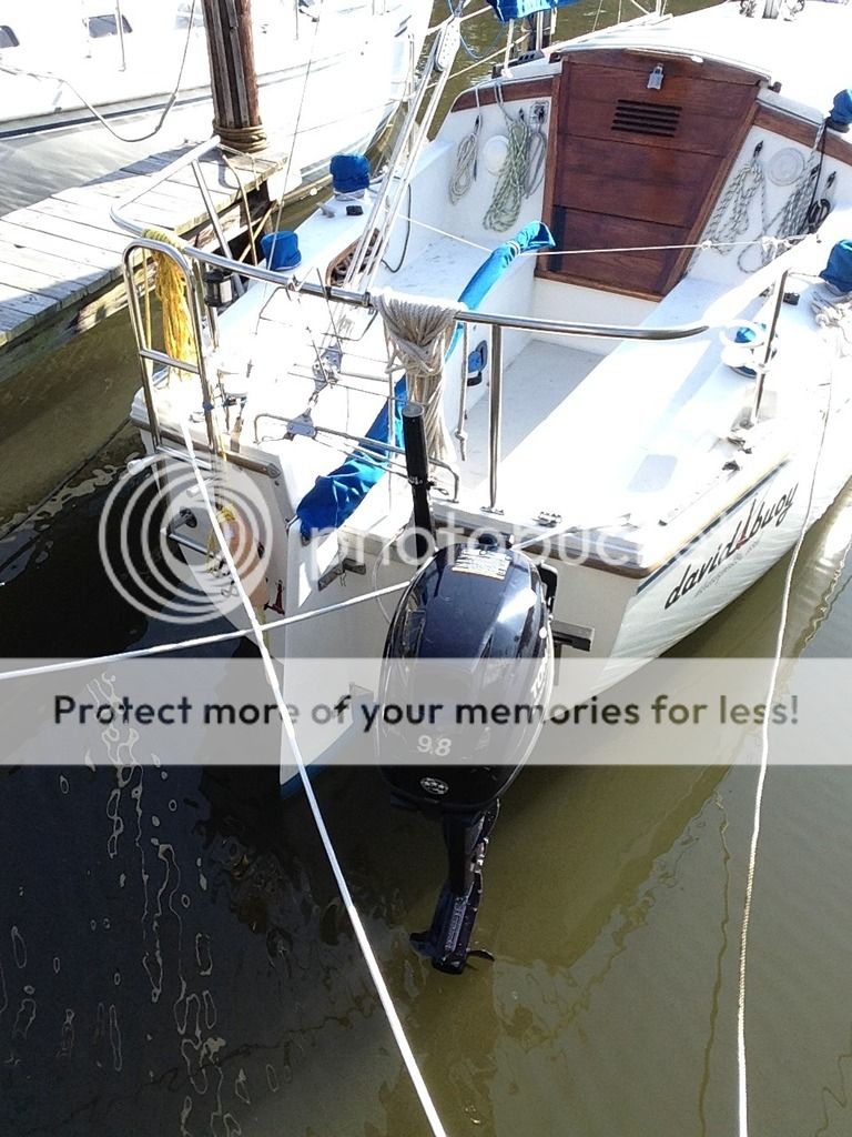

Just got my new Tohatsu 9.8hp delivered and put on the boat! Used Onlineoutboards.com and was very pleased. Even though there was some delay getting the motor in due the storms, it arrived in less than a week from ordering and they were great to deal with. Planning to get oil in it, wire it up and start the break in process tomorrow. I will say, this motor is definitely larger and heavier than the 6hp I just sold to Steve. I'm going to try to rig a block and tackle to help raise it during the remainder of the season and am considering a stronger mount next spring. Are there any options for adding an additional spring to my existing mount? Anyway, real excited to hear it start up!

You will LOvE that motor, assuming it is elec start and 25" shaft! You will need 3 springs on the mount, 4 will be too much.

Got two hours of break in complete tonight. The motor really pushes the boat with ease. We were doing 5kts at 1/3rd throttle into a fresh breeze and chop. So I can pull the motor up with some strength but definitely too difficult for the fiancé. Going to try and put a purchase on it for the rest of the season but I don't see a better recourse than a new motor mount (mines only a 1 spring). I just hope the bolts line up and it's not too difficult to do with the boat in the water.

Same engine here, electric start, 25" shaft. Had the original 2 spring mount. Could barely lift it out of the water. Installed a 4 spring mound from CD last month. Much better. Specs say the engine with electric start is at ~94 pounds. According to CD, the cutoff from a 3 spring to 4 spring mount is 95 pounds. So you can go with either. With a 4 spring mount, it just pops right out of the water. But you do need to give it a little push to put it in the water. Also, don't forget to order the transom backing rails. Thats a lot of weight cantilevered of the back.
