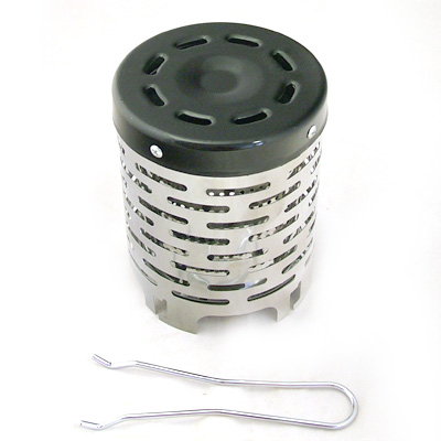

Response Posted - 12/14/2016 :  07:18:21  Show Profile  Visit Tomas Kruska's Homepage
I would like to share my experiment with this add-on:
http://wesailphobos21.blogspot.cz/2016/11/cabin-heating-alternative.html
Dalpol Phobos 21, 2013, Sole Mio, hull #27, current adventures - We sail Phobos 21

Tomas: I have the same detector as you and using the fired ceramic pot, I have never tripped the detector. Heats my boat great! Chief

Response Posted - 12/14/2016 :  08:53:38  Show Profile
Hmmm... I was following this thread to see where it led... Most common types of combustion produce CO, which you don't know you have until it quietly puts you into a comfortable sleep--forever. A detector can be fooled--especially if it's not on or near the cabin ceiling. CO is about the same specific gravity as air, but warm CO is, of course, lighter than colder air. So placement of the detector is critical.
But I would never use a system that uses an flame where the combustion gases are not channeled through a pipe directly out of the cabin--especially when sleeping! A slightly open hatch somewhere is too random. The clay pot and Thomas's "radiator" are good for capturing and radiating some of the heat, but the flame from a carbon-based fuel is generating some amount of CO--who wants to guess how much? Who wants to bet lives on a CO detector operating properly?
Curmudgeon out.
