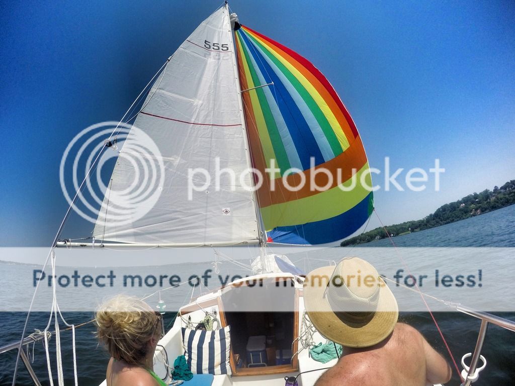

We have a very similar sail. It's actually pretty versatile and sails great close reaching to deep reaching and we've even tried it wing on wing for fun! Ours has the hank as well and two different colors on the tack and clew, as well as there is a sewed on label on the tack. Other than that though, it appears nearly symmetrical.
I think generally for non-sailing friends/crew I call it a spinnaker, but really its a gennaker.
Another clue for you is the swivel on the head. That's not something that would really be necessary on a symmetrical if you think about it.
At the dock you can tell the cut is pretty symmetrical:
Reaching:
Wing on wing:
This picture you can kinda see how once it starts filling up, it does change its shape to a more familiar assymetric shape:
