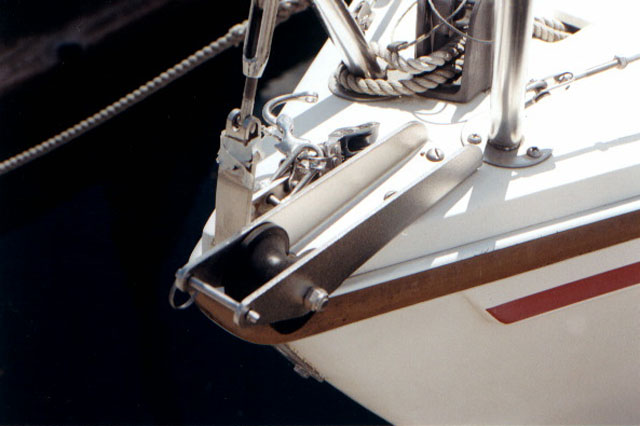

Response Posted - 07/29/2017 :  11:18:33  Show Profile  Visit Peregrine's Homepage
Originally posted by Peregrine
"...so the the fitting can't be ripped up along with a piece of the deck, as we've seen here."
Did you mean to include a picture with your post?
Here's a thread with several.
Note the lack of the tang bolted to the bow below the rub-rail. Catalina had recognized this weakness by 1985 when mine was built. CD has the upgrade with or without the roller.
Oof... That's brutal.
The AR Bow Roller I installed is a separate unit that that does not replace any part of the fore-stay. Rather it bolts through the deck NEXT to the fore-stay.
Here is a picture of Bill Holcomb's bow roller that I copied. I just mounted mine on the starboard side.
Easy installation with no issues with the fore-stay or rub-rail.
Follow Bill's post for installation details.
