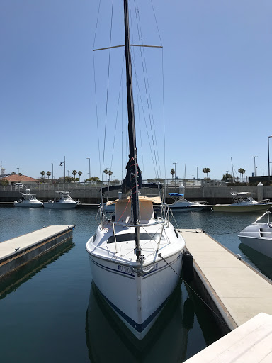

Well...
Most of my major mods are in place and the weight did have an effect... a big-ish list to port. Hopefully several lead ingots or a few bags of landscape rock placed starboard can bring her back on center...
Response Posted - 06/02/2018 :  10:24:39  Show Profile
Funny but that looks like it's listing to starboard, not port. Your port side is against the dock.
Edited by - islander on 06/02/2018 10:28:43
Carl in LA
284 Posts
Response Posted - 06/02/2018 :  16:51:10  Show Profile
Nothing too funny - I'm just bass-ackwards... I should have studied this photo.

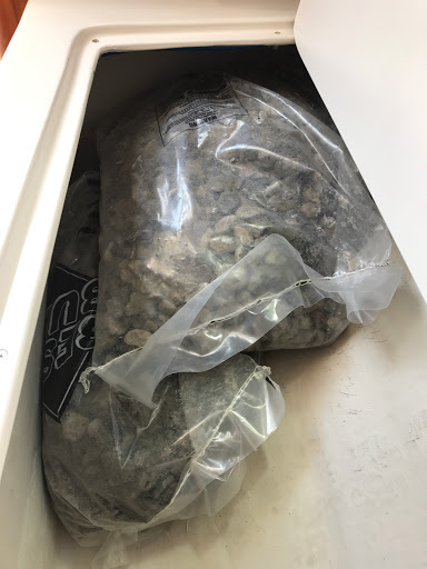

Carl in LA
284 Posts
Response Posted - 06/06/2018 :  16:38:19  Show Profile
Noted Russ...
I dropped a sack of stone into the port settee hold (while on the trailer) - I'll see the results tomorrow when the boat is launched.

Carl in LA
284 Posts
Response Posted - 06/18/2018 :  17:51:19  Show Profile
Russ... I keep nothing in the forward hold due to the inaccessability.
The boat required two 60-lb bags of gravel to bring her back on keel.
Crazy - but happy for all of the improvements that caused the list and perhaps someday in the future finding some affordable lead ingots that will replace the gravel... probably a lot of air space in those gravel bags.
