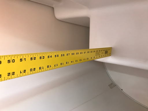

Clutter on the boat was getting out of control to the point that you could no longer see the galley surface. A set of shelves in the aft berth seemed to be part of a solution.
The idea was to use some of the dead space around the outline of the cockpit above.
The material is 1/4 plywood with 1" by 2"'s used for fiddles. Dimensioning of the shelves was targeted to match locally available plastic storage bins.
Anchoring is accomplished at the bottom by small blocks of wood screwed to the aft berth sole. Anchor screw lengths were carefully chosen not to threaten the hull underneath the the liner. The top floats free but is constrained by its fit behind the cockpit outline.
As for the cushion that goes on the starboard side of the aft berth - not sure what to do about it yet... one idea is to leave it intact and store it at home for a future owner and just make do with only the port side cushion... another idea is to take the starboard cushion to the upholsty shop and have them cut down the width to re-fill most of the empty space. Temporarally a solution may be to cover the berth decking with indoor/outdoor carpeting. Another cruising idea may be to remove the port cushion slip a twin-size mattress in there...
Clearly I'm no cabinet maker and the fit and finish is rough. Nothing is installed that can't be removed.

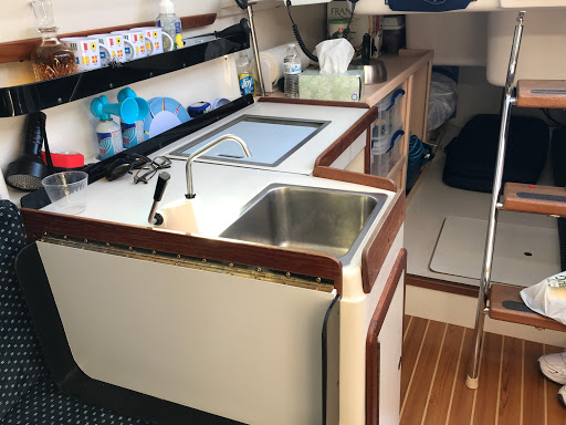

Hi Russ:
Yup. A wing keel for me. Hopefully I never regret that decision.
I did add a folding shelf going forward from the galley. It still does not have a means of holding itself up and just using a wine box for now. The additional work surface was needed to have space for a dish drainer near the sink.
Interesting observation about the hatch in the aft berth. Its pretty shallow underneath but good for some storage - very at risk for being wetdown that low in the boat though.
