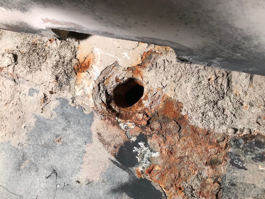

I purchased my 1982 Catalina 25 last October. I knew there was something wrong with the keel right away. I had trained on another 25, or I wouldn't have even known there was a problem
I noticed a slightly clunking sound coming from the hull. It almost sounded like the waves hitting the hull, but it didn't seem to match the rhythm. Was thinking it might be loose rigging that would cause the mast to make noise through the hull, but something told me it was the keel.
Asked the previous owner if the cable had replaced or inspected, which it hadn't, and he had owned it for over 7 years. This boat has mainly been sitting in a fresh water marina but pulled out every winter. Reading stories about dropped keels I decided to immediately get it out of the water.
I then checked the keel I found it was greatly worn down. Tons of side slop and an oblong hole. It measures about 1 1/4" on direction and 1 5/8" another.
So I ordered a new pin and a sleeve. I have read about epoxy, but what about trying to weld it in? Since the keel is cast and probably not the best quality and full of impurities, is welding even an option? Is it still OK to use epoxy with this much wear?

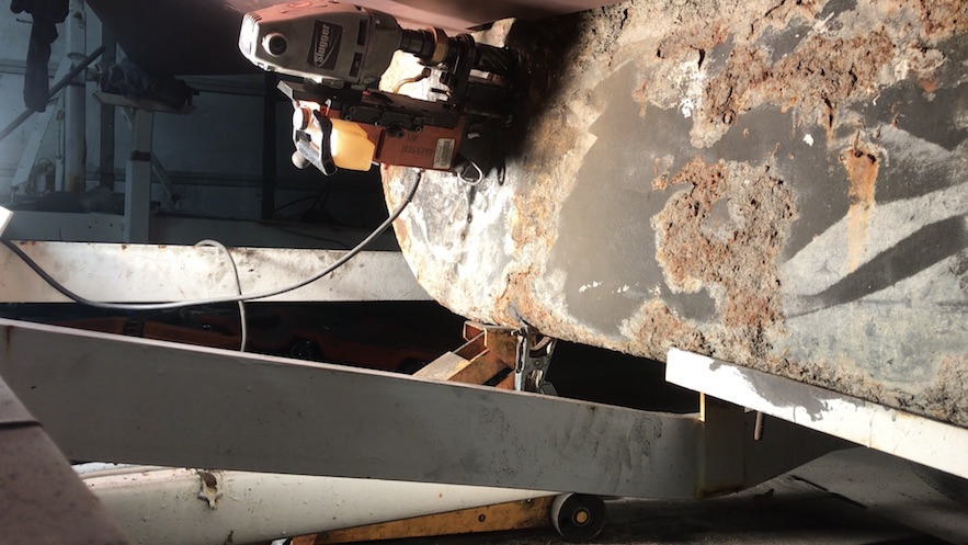

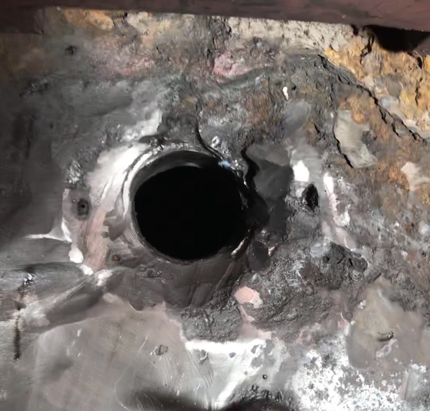

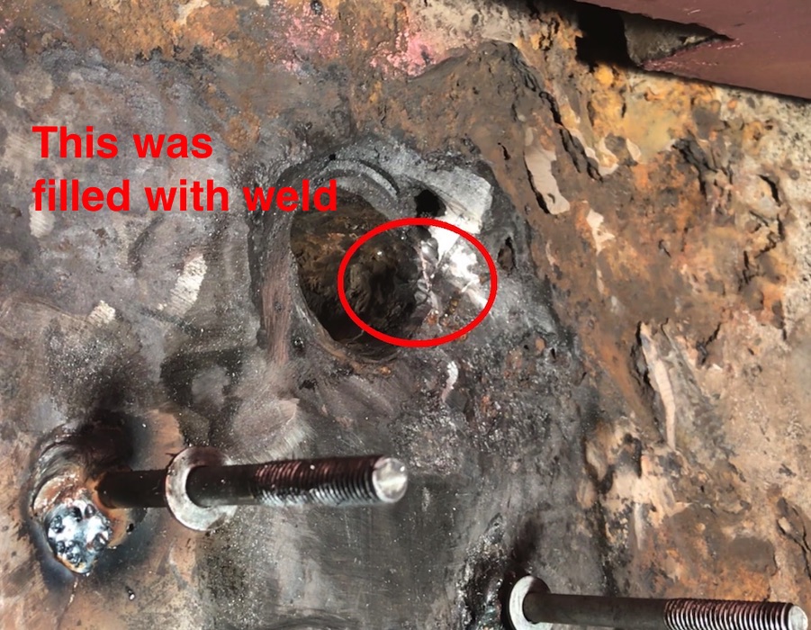

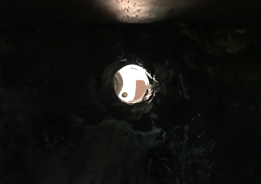

So either someone has attempted to repair before and glob welded a ton in and around the hole. This made cutting the new hole VERY difficult as my cutter won't cut through harden weld. So instead I spent about 9 hours, drilling, then with a fine tip tapered carbide burr, I would poke holes around the ring that was created by the cutter, then drill, then poke, then drill then poke, and about half way through the keel I finally got through all the weld crap and punched through the rest in about 30 minutes. For mounting the drill, I couldn't get a smooth enough surface and the depth of the drill was only 2 inches, so welding on a plate for a 100% flat surface wouldn't work and I ended up welding on a couple bolts to the keel and used a strap across the base of the drill to hold it to the keel.
Drill cost me $150 to rent for a day, and the 1 3/4" annular cutter cost me $140. So overall cost to cut the hole was $290. I haven't got the bushing yet, but I got a 1-11/16 " OD with 1"ID x 12" for $80. it will be a little bit of a loose fit but that is good since there really wasn't a good way to make sure the hole was aligned with the keel. This should give me enough play to have it aligned.
Total cost to fix... around $370 + a lot of work.

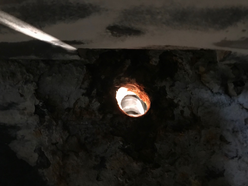

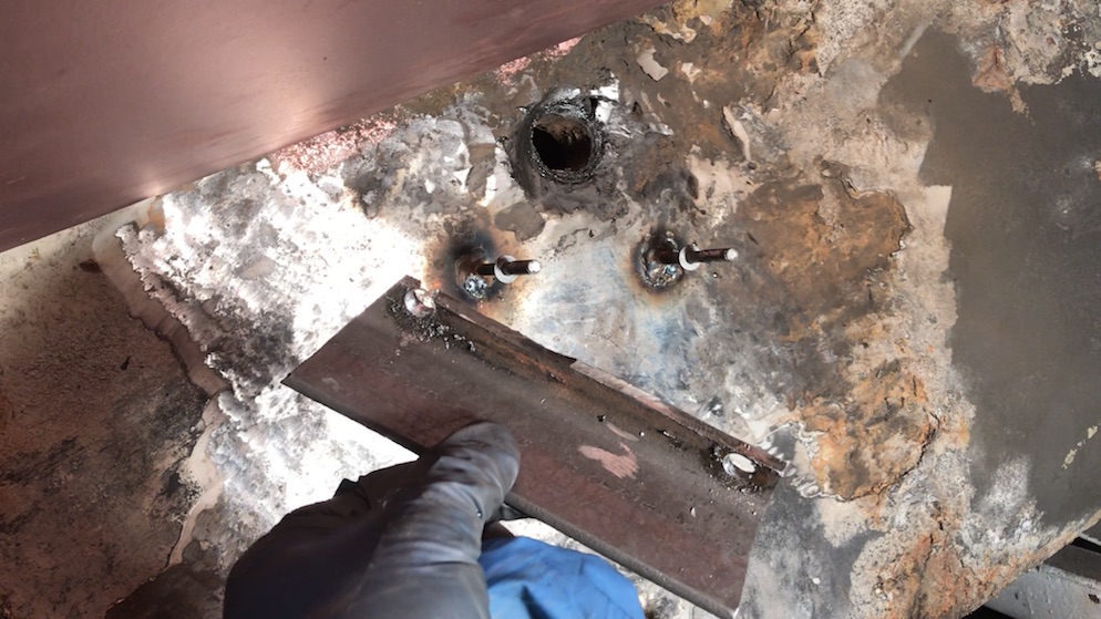

Response Posted - 02/20/2018 :  09:30:40  Show Profile
Here are a few pics.

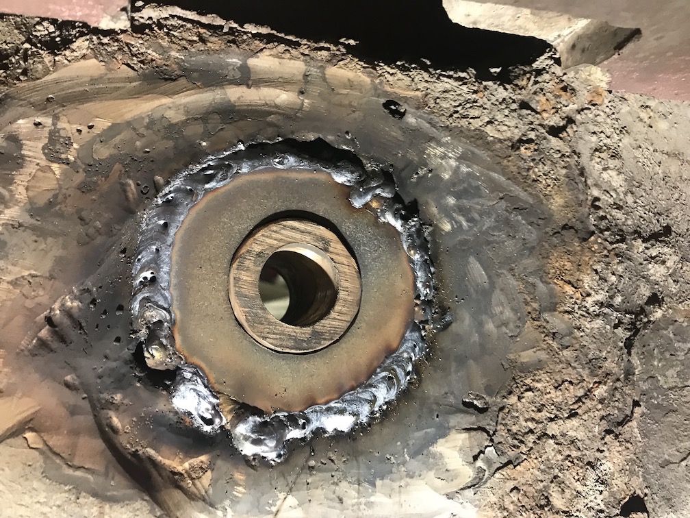

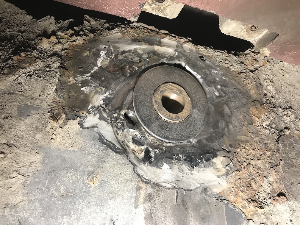

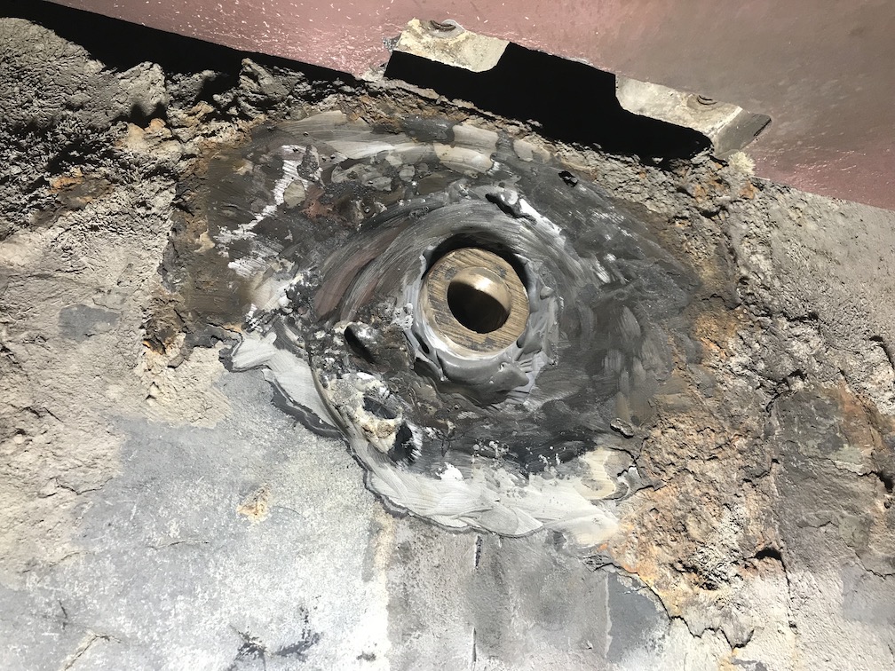

Response Posted - 03/15/2018 :  19:09:57  Show Profile
So got some work done this week. Used a 1 5/8" brash bushing which then I epoxied in and let the keel hang under its weight to make sure it would set inline. Then I ground down material around the bushing so I could fit a 3" washer. There was already quite an indentation around the bushing just from wear. I then welded the washer in place.
The washer will take most of the twisting load from the bushing instead of the epoxy. This should work out great as that bushing will be replaceable if needed, and could always cut out and re-weld in new washers if the welds rust away.
I dont' know why they didn't make a replaceable bushing from the factory.
