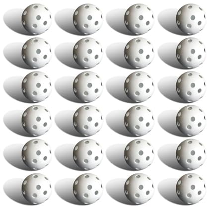

...or, string a few of these practice golf balls on a line.

Steve, I was thinking of something like those balls or even the floats on ski lines but the problem with them is that they are hollow and probably will crush creating a flat spot and stop rolling.

It's certainly possible that practice golf balls might be crushed, but I don't think it's a foregone conclusion. I think that might depend on the configuration of the slip and other factors.
Consider, for example, my Cal 25 slip. There are only two pilings, situated just about abeam. I tie docklines to the boat's bow cleats and lead them aft to the pilings, leaving a little slack to allow for the rise and fall of the tides. Those bow lines prevent the bow from drifting forward into the fairway. I tie spring lines from the same pilings aft to the boat's stern cleats, and adjust them so that the boat can't drift back far enough to rub against the dock. There's no finger pier, so I have to board at the stern. Those two lines restrict the fore/aft movement of the boat. Those pilings are only about 4-5 inches from the rub rail on each side, so they restrict the lateral movement of the boat in the slip.
Finally, I tie stern lines so that they cross the stern, to the cleats on the opposite sides. Those lines never bear much of a load. They simply restrain the stern from moving laterally against the boats on either side. Those are the two lines where a "Tideminder" type of device would be used.
Since the cost of making a tideminder clone out of practice golf balls would be negligible, I think it's well worth an experiment.
I'm an absentee boat owner during the winter, and rely on my dock neighbors and other friends to adjust my lines as needed while I'm wintering in Ohio. If it works, they might not have to adjust them.
The tideminders are larger than golfballs, more like the size of a baseball. They are also rounded on the inner hole to prevent chafe. I think I paid around $40.00, didn't feel like fooling around trying to reproduce them. I will say that they worked well, even at extreme low tides that had the device rolling on the barnacles.

Thank you for all of the advice. I probably should have mentioned that I keep the boat at a marina in SF bay where the surge is pretty bad and the tidal range is ~6ft. So no, some plastic golf balls aren't going to cut it. And while the piling I need to tie off to is currently all mine, there is a slip next door that can use it too, so I was a little worried about possible tangling. I ended up waiting for low tide and used my boat hook to dredge up the auto tire from the bottom of the bay. Its the method that all of my other neighbors use to tie off. And it is free. Appreciate the advice though.
