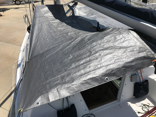

I used strings representing the edges of the canopy to make measurements. And as a proof of concept - I made a template out of a tarp. The template exposed that I needed to make the span smaller at the aft end.

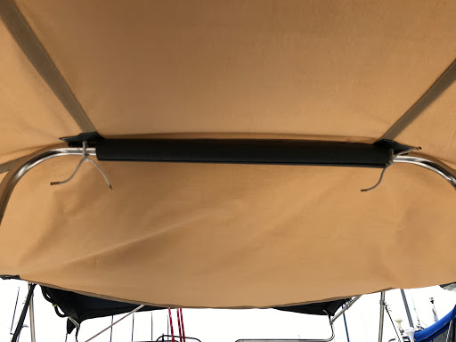

The canopy is tied to the Catalina 250 tent support bar.
