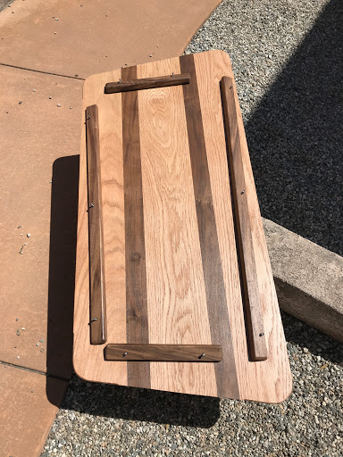

The salon table in Hull 922 that came with the boat is a very nice table but it did not sit well for me... table too long, not wide enough, heavy, too low on the pedestal, just did not work for me. I took it off the boat never to return.
After dealing with a few other fixes on the boat it came time to redo the salon table.
The new table is fabricated from red oak and walnut...
Carl in LA

The ability to customize is one of the likeable things about boating as a hobby.
I see what you did and I like the outcome...

Originally posted by WK 727
First, I gotta say that the original table is beautiful! I hope someone on this site wants it, if it never returns to your vessel. I went a slightly different direction and cut my PO custom table down in size. The standard size was so difficult to slide around that I trimmed it. I prefer the smaller size and more room. Cabin tables are one of the most customized features and shows everyones personal preferences. By the way, your new table is striking and serves your purpose well. Thanks for sharing. John
