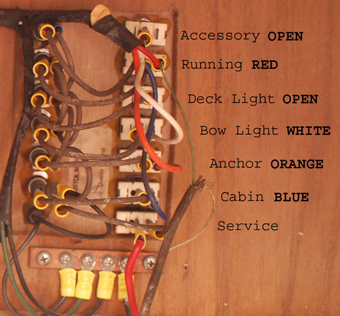

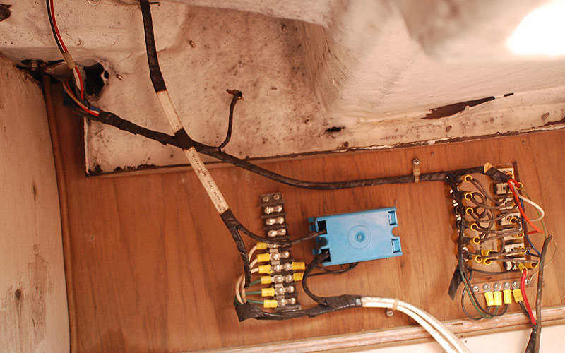

this is mine ( 1984 ) before I rewired, behind the panel.
As best I could tell these were the circuits.

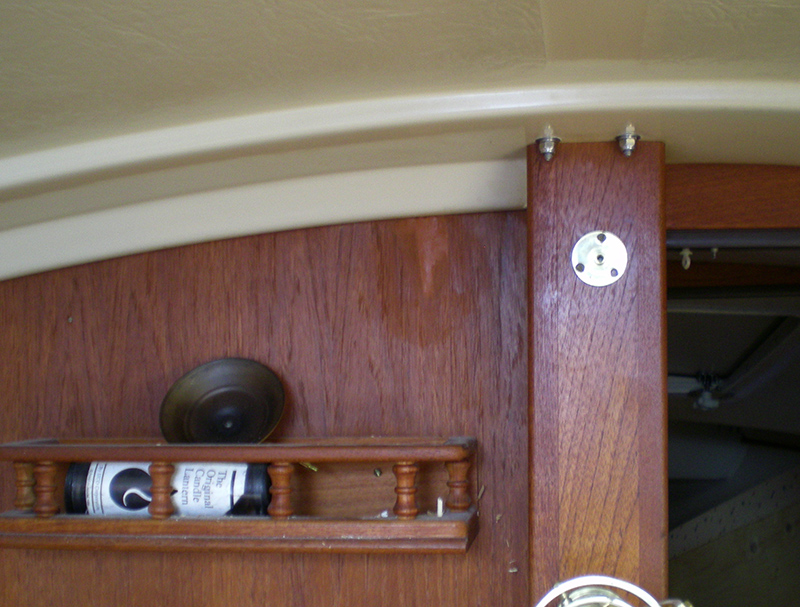

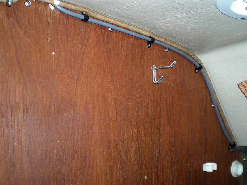

Here's my job with images from both sides of the bulkhead and a shot of the deck fittings.

Tim,
That’s a very nice job using the junction box. I like the reading lamp too. It was good that you could add the VHF feed through in the old mast cable location. Having a 25 foot VHF antenna mounted on the mast top provides a dozen miles or so more range than the range you get by mounting it to the stern pulpit. Geometry beats more power every time.
Response Posted - 09/16/2018 :  22:45:28  Show Profile
Ray, I can’t believe what I’m seeing behind your power panel inside the fender locker — aka the dumpster. 120 VAC neutral and grounds intermixed and completely exposed for any unwitting scrounger at the dock to get the lesson of their life, maybe the LAST lesson of their life.
Ha, but you said that this was before you rewired the panel, I’ll bet it’s much better now.

Response Posted - 09/17/2018 :  19:11:43  Show Profile
Yepper... I don’t use shore power.

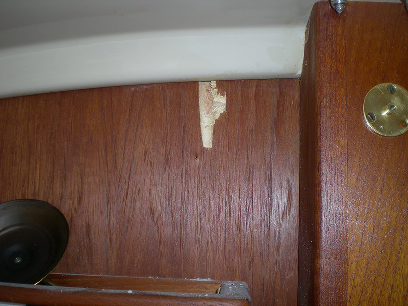

I did the same as Redeye, i ran a new 4 wires tinned cable from the back of the panel, under the recess where the stanchion bolts are, all the way to the bulkhead, i drilled all the holes inside the recess so they don't show and i pulled the cable at the top of the head's side of the bulkhead and drilled a new hole where the old deck connector was... (the old cable didn't carry current to the deck connector anymore and the connector was old and corroded so i just cut the old wires where they where coming out to the switch panel and drilled a new hole over the old deck connector hole, filled it with epoxy and drilled a smaller hole in it so the cable would pass and put a brand new connector, that was 7 years ago and everything still works perfectly)
When I drilled the deck i was aiming for the inside of the head but it seems the original deck connector was right on the bulkhead... ooopsy!
I managed to fix it (barely shows when in the boat)

Response Posted - 09/30/2018 :  09:16:32  Show Profile
That's why they make wood filler, For the Ooopsee.

Thanks for the pics blanik, very helpful. I will probably end up doing that same thing and be done with it. As far as drilling down from the old connector location, I had read a couple of comments about drilling on an angle forward, guess there is something to that!

The problem with drilling at an angle is that the deck connector might not lay flat on the deck when you install it, i actually drilled into the old connector hole that was straight on the bulkhead, i just drilled too deep, i should have put a tape on the drill bit to mesure how deep i was... not a big deal anyway, just caulk the deck connector with 3M 4000 and voilà
