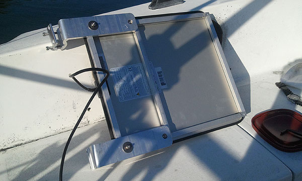

I have 2 batteries, generally use them for light duty, running the fishfinder, occasional use of the nav lights and/or fans and same goes for very limited use of a mini-boom box. I have found that the 20 watt rigid panel that I have been using for over 10 years has been sufficient. It has a 20"x14" footprint. Perhaps a better choice for a 2 batteries and moderate loads put on a weekly would be a 30 watt panel which you can get in a 20" x 20" configuration and hang off the transom rail. As far as solar controllers go, you can get a digital readout one like I have or a much less expensive one that has no voltage/current readout - This based on your preferences and spare dough.
Here are a few photos of my setup but there are more photos and details on my website. By the way, my mounting hardware allows me to remove the outboard without dismantling the panel. It is high enough that it does not interfere with sitting close or resting against the transom area and I can tilt it during the winter months when the sun is lower in the sky to maintain it perpendicular to the sun. Using wing nuts facilitates tilting it and if I ever have to dismantle it.
