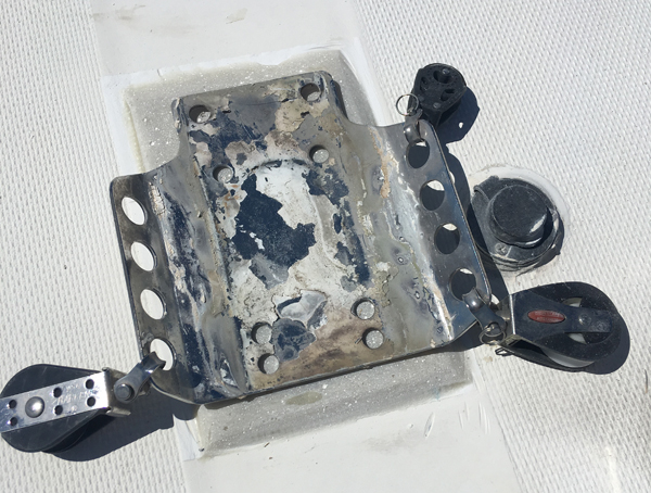

Initially Posted - 03/13/2019 :  05:22:02  Show Profile
So anyhoo....
The area under the mast plate ( what is that area called? ) is cracked, caved in some, and I would guess it is leaking into the deck. Not good. Right now I've got it gooped up with polysulfide thats probably 5 years old.. again not good.
So I want to drop the mast and build up the area with G-flex.
My problem is that my midstays are almost all the way out so I expect I might have to cut off an inch of the bottom of the mast if I build up the area a half inch. I also have extension shackles on my forestay.
SO thinking out loud to hear your most interesting opinions before I attempt this project at the end of this month.
regards.ray

My first thought is "building it up" might not be the answer if the problem is deteriorated core between the deck molding and the compression post below. The problem could re-appear... It might be more important cut it open, replace the core (I assume there's core there), and re-glass on top of it. And I'd use something other than wood if that's what's there. (Starboard?)

Or another way would be to remove the plate then drill a series of holes in the fiberglass to get to the wood underneath then pour in a healthy amount of Git Rot. After that you could level the area with epoxy and fiberglass cloth. Ray, Check the bottom of the mast post in the bilge. Look for any rot or movement. Could be that the post is the problem. Not sure why your stays are maxed out. You would think with the mast sinking into the deck it would be the other way around.

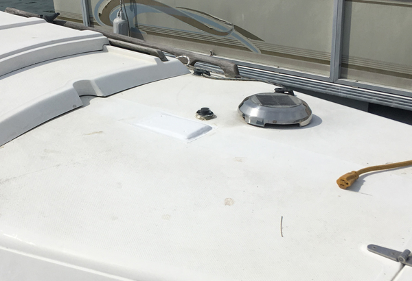

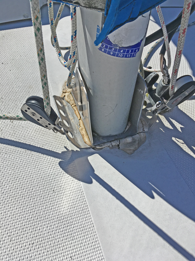

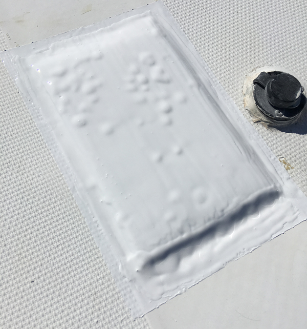

Response Posted - 03/18/2019 :  07:34:45  Show Profile
It just does not look that bad...
But water into the deck is Baaaaad.......
Edited by - redeye on 03/18/2019 07:36:54
4034 Posts
Response Posted - 03/18/2019 :  08:36:53  Show Profile
The caulk looks like it's failed and died of old age. Probably what started the problem.
Response Posted - 03/18/2019 :  10:30:20  Show Profile
That "not that bad" was satire... that mess of goop is gonna leak. I was clearly putting off a job, that even with dropping the mast, is not that hard.
I don't have a dry place for the boat so work is between the rains, every 5 days, mostly the weekends. I post the picture to embarrass me enough to motivate, and for others entertainment.
I kinda wish I could just set the mast step aft and work on it but that sounds like asking for a real problem.. and I want to work on the chicken vane...
So I ordered my materials from Jamestown Distributors ( lots cheeper than West Marine )
git rot, G Flex, and Gel Coat....

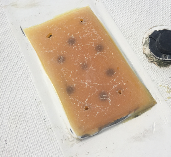

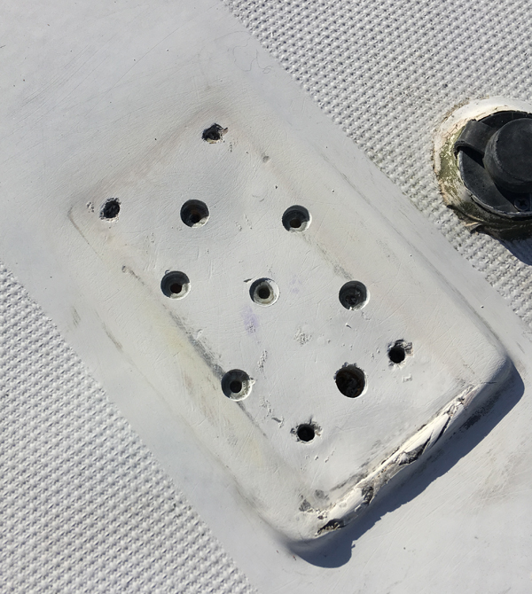

Response Posted - 03/24/2019 :  20:15:44  Show Profile
So Anyhoo...
First use for my folding a-frame with excellent results and somehow we broke the wind vane so I've bought the bigger one with the center bird spike sticking up so that should be a fun upgrade.

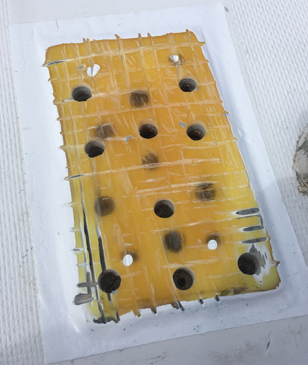

Cleaned up, sanded, wiped down with MEK,and drilled out the deck, finding the wood core dry and sound so many of the holes were not that deep, concerned the resin might go everywhere into the deck. silicone plugged the underside of the bolt hole openings. Very little resin dispersed into the deck. I was kinda surprised.

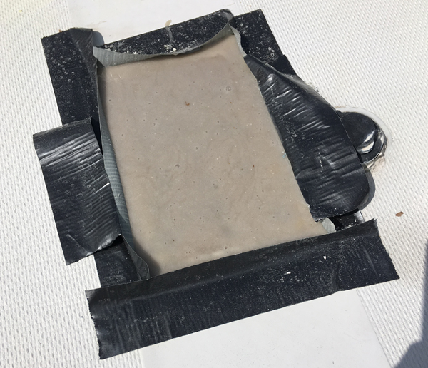

Made a tape dam rectangle around the step and poured in G-flex resin. Let that cure overnight and most of the next day.
( using a portable generator, as my dock is not a power dock ) cleaned up the edges with a cut off tool and sanded with a heavy grit. Drilled the mast plate holes.

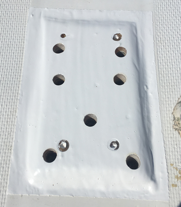

Today I taped off the area and painted 2 layers of gel-coat and its curing tonight.
Tomorrow we expect rain. I'm hoping Tuesday I can sand and add another layer or two of gel-coat with a little bigger footprint.

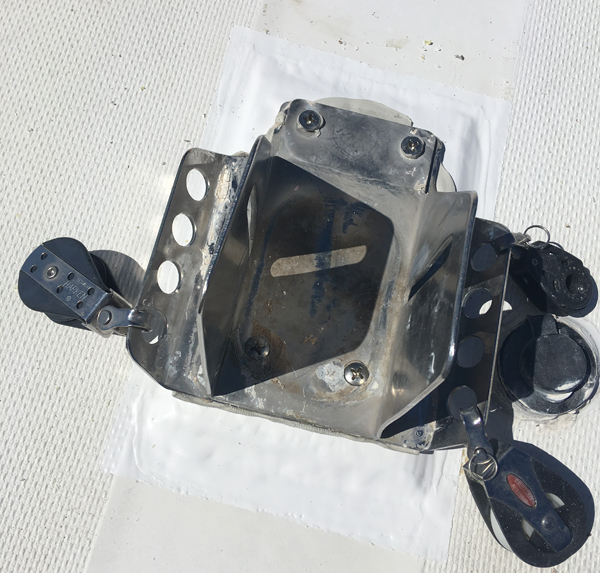

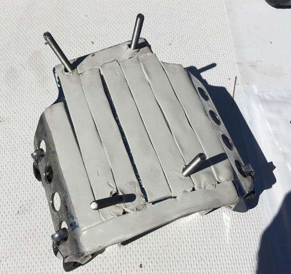

Wednesday drill out one hole, add the mast plate, mast step, and drill the other three holes one at a time with the plate and step in place, using butyl tape between the mast plate and the deck.

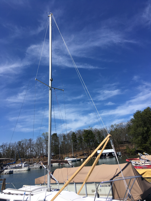

Then step the mast and tune the rig.
My memory for the standing rigging turnbuckle adjustments was wrong, the for and aft stays are out, with added shackles. The midstays ( lower shrouds ) are tight, and the upper shrouds are about midway.

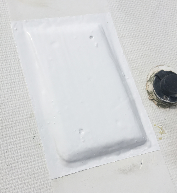

Response Posted - 03/26/2019 :  15:19:14  Show Profile

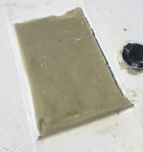

Yep ... really found the G-flex to be rather soft for a patching material of any depth, cut like butter with the cutoff tool. So I drilled it out down to the inside liner. I could feel the drill bit hit the liner after going through the wood core.
Cut out lots of the patch.
And cut out even more and sanded it down, wiped it down with MEK and drilled more holes.
built a tape dam and filled it with west systems resin with high strength filler.
Looks like the front hole is seeping into the deck, probably hafta add yet another small dab of resin...
So tomorrow it will be gel-coat
Response Posted - 03/29/2019 :  11:13:59  Show Profile
welll... got the patch sanded down and gel-coat done, butyl taped the underside of the mast plate and bolted it down... finally get to go sailing tomorrow.
