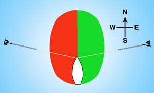

Different forces are at work on a sailboat above and below the waterline, even when it's at anchor. Above the waterline, the wind is blowing against the hull. Below the waterline, the keel hangs down providing resistance to any lateral (sideways) movement of the boat. When a sailboat turns, it rotates on it's center of lateral resistance (CLR). As the bow of the boat falls away from the wind, the stern rotates toward the wind.
There's more above-waterline surface area in front of the keel than aft of the keel. When the wind blows on the hull, there's more pressure on the hull in front of the keel than aft, so that causes the bow of the boat to fall away from the wind. When the boat tries to sail away, the anchor line prevents it, and pulls the bow back the other way. When the wind starts blowing against the other side of the hull, the boat tries to sail off the other way until the anchor line pulls it back. The result is that the boat oscillates back and forth at anchor.
The way to prevent it is to raise an anchor riding sail near the stern of the boat. That increases the windage aft of the center of lateral resistance (which is located approximately in the center of the keel). The effect of the riding sail is that the wind pushes harder against the stern of the boat than the bow, and that causes the boat to point into the wind.
