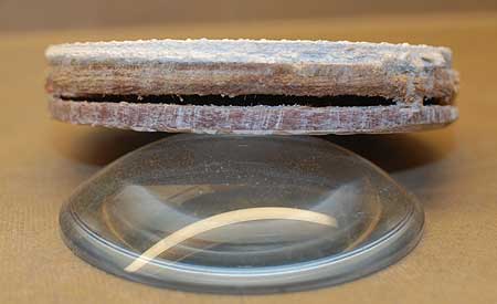

This is a part of the deck I removed to add a vent to the forward port side of the mast. There is a liner in that area and part of it meets top to bottom with resin filling in between. One side has a bit of a gap.
Both sides of the same disc.
So I expect some areas have gaps between the liner and the deck.

Besides "over drilling" the holes, filling with epoxy and re-drilling. I took a bent finishing nail, put it in my drill and reamed out the space between the liner and the deck. That area, as shown above, has a wood filler and it may be water damaged. By reaming it out the epoxy will fill in and restore the structure so no more water can get in there.

Thanks guys! And Redeye, those photos are fantastic- thank you!
Do you happen to know if there will be the same makeup near the stern of the boat, say.. near the aft quarter cleats?
For some reason I figured "liner" meant two fiberglass bodies with a simple void in between.
Response Posted - 05/09/2019 :  18:20:21  Show Profile
Oh there's voids especially around the windows. I think the cabin top and side decks including the cleat areas are solid.
