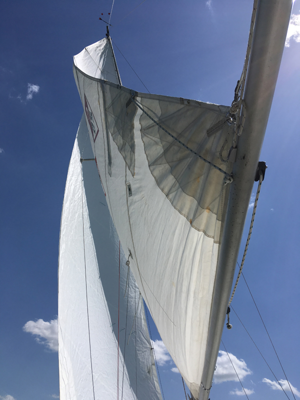

I sail my 150 with the car close to the winch, just ahead of it. A new sail.
That image of a catalina 25 must be from a very early version. The track is inboard from my 84 and the lifeline connects to the top of the bow pulpit, also unlike mine. My sheet have always run outside the life lines.
I'll see if I can get my brother to photograph me again now, with the new sails and all. That would be interesting.
So anyhoo... I think most of the cars are further forward than you would think on new sails. You see most pictures of the catalinas with excessive twist in the jib. If the car is too far back the leech start to flap with more wind and you have to tighten the leech line and sometimes bring the car forward. As the sails get older and more blown out this becomes more so, and then sometimes they get so blown out you have to open the leech by bringing the car back to open the leach. ( and they can flap with higher winds. )
I sit on the downwind side and look up at the slot and the sail and try to figure out where to put the car on any given day.
I've had three sets of sails ( 3- 110 and 3-150 ) over the years at various ages on the sails and this is pretty much the best I can verbalize it. I don't think I knew what the leech line was for the first 5 years, much less how to adjust it.
This is a shot from this March... Trying to gauge the slot.
